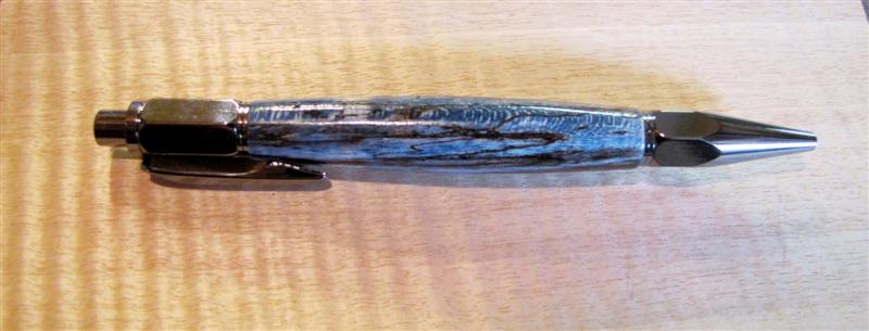

I have had some recent success with curly maple,spalted maple and spalted hackberry taking dye real well.
The dyes I have been using are $4/8 oz of RIT liquid fabric dye.I apply to my sanded pen blank and then coat with CA finish polished out with MM.

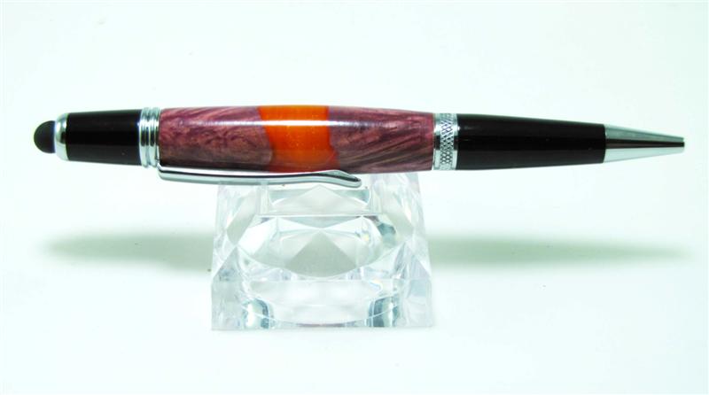

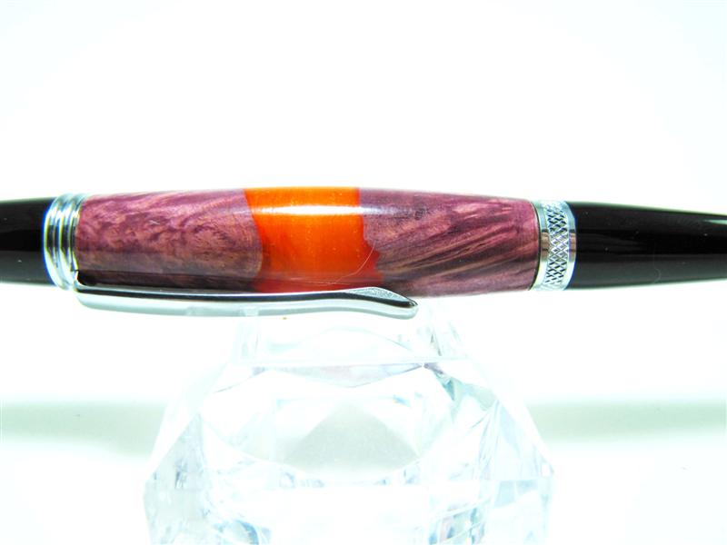

I recently made this pen using curly maple and Purple TransTint dye.
Mixed about 10-15 drops of the TransTint dye in 2-3 tablespoons of denatured alcohol. Applied with a shop towel. Finished with CA.
