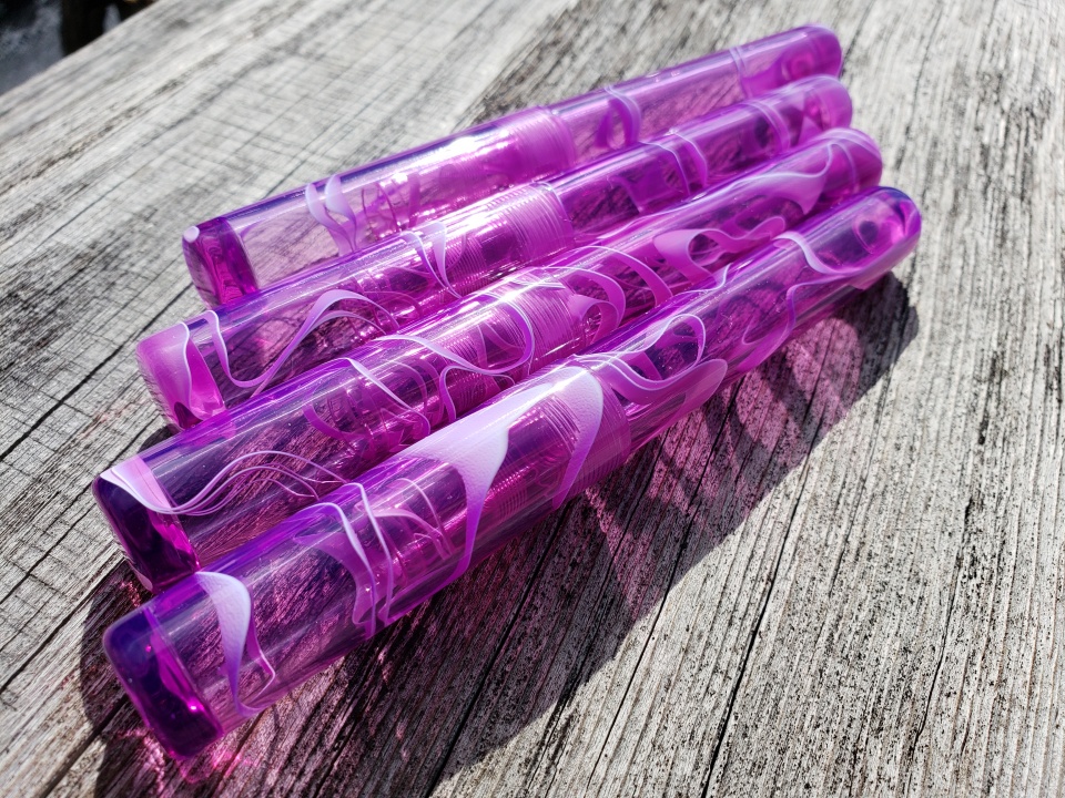

Purple Passion acrylic kitless pens completed for an order. These take #6 JoWo nibs.
Wow! Beautiful work. I am particularly impressed with the interior polishing. (Drop me a PM if you are dying to share your tricks.) Fantastic looking pens!
(BTW - I have used many of the blanks I got from you in the lot purchase and love them. Please let me know if you're getting rid of any more. Fabulous pours, all of them.)
Thank you Gregory. I'm happy that you've enjoyed the kitless blanks. Right now, I don't have any that I'm getting rid of.
The interior work starts with a good drill and ends with lots of sanding and polishing. If you can manage to drill out the interior and have a clean cut, it'll go a long way to making the rest a lot easier. Dont be rushed with it.
