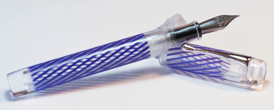

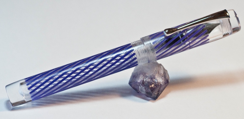

This one was just for fun -- purple mica polyester resin in clear lucite. The inlays were cut with a CNC mill, then filled and re-turned. I figure Spring's coming (at least here in the Southwest), and those purple crocuses will be up soon.
Thanks for looking.
Doug

"Just for fun"??? ... Pretty incredible! So what do you do for serious work... :).
Thanks for posting - REALLY Nice Pen!

Can I ask how you're filling in the areas with resin? Are you using a rotisserie type setup?
The slots are so thin (3/64") that surface tension holds the PR in place until it dries. I do wind up spinning it manually for about 10 minutes until it sets somewhat. I've found that as long as I just fill the slots and don't overload it with PR, it can pretty much cure by itself without mechanical turning.
