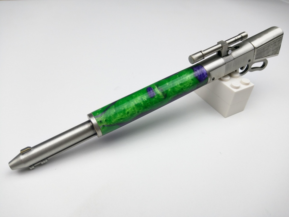

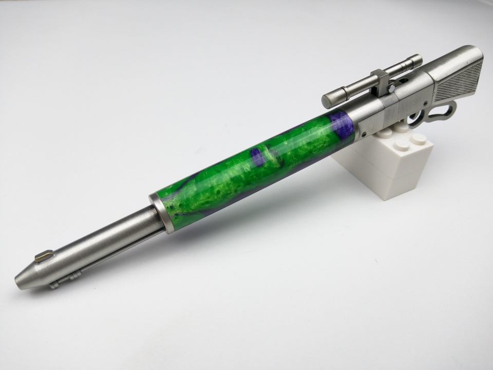

I agree with the Lever Action kit, it's kinda neat but almost useless as an actual pen. Wasn't impressed with the work needed to make the stock fit right either.

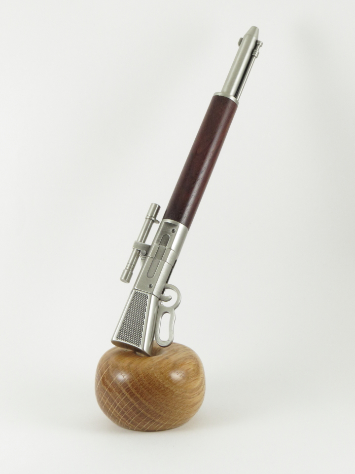

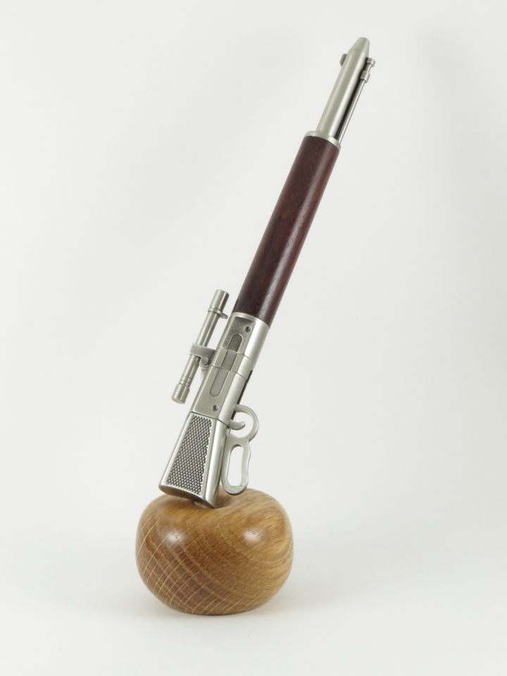

Made one of the lever action as well. Will not make another.
Donated it along with a bullet pen that I didn't make to a Friends of the NRA banquet. Live auction item for choice of one, double your bid and you get both.
Bid went to $100 and buyer doubled. So helped raise $200 for FNRA.
