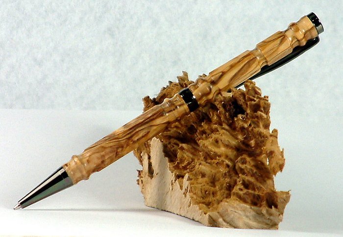

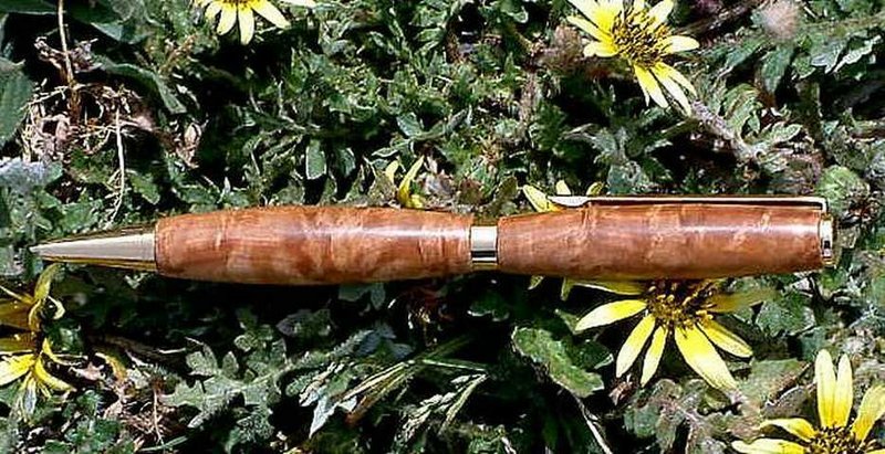

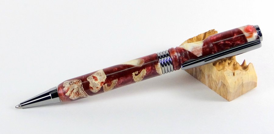

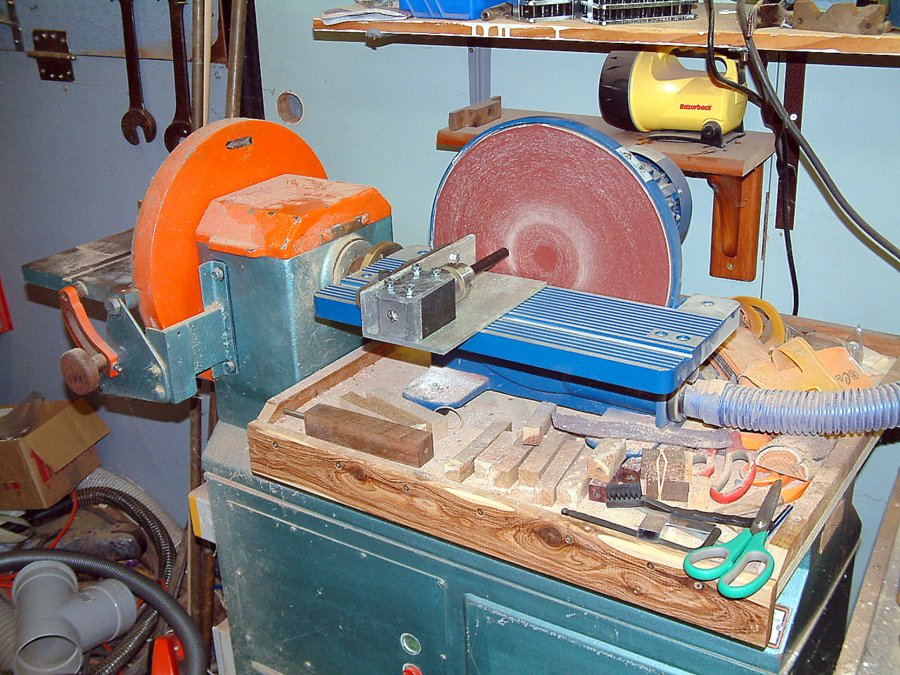

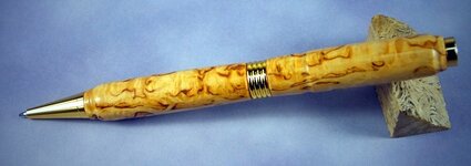

Two things come to mind.....1.Which centre Bands skinny or Streamline bands?

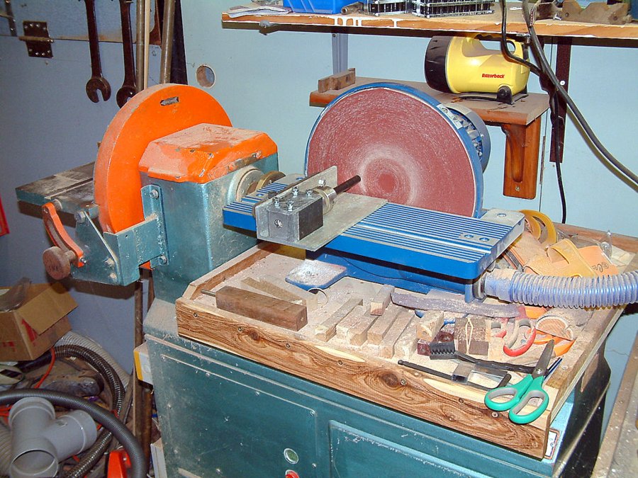

2. What punch et al you hold the blank on your device any slop in the fit? Where on your abrasive wheel you finish the facing,I find toward the centre is the least likely to be out of whack. Also it is critical to absolutely square from the holding post for the bank in every direction to the face of the sander.
Having done this examine your point to point relationship in your lathe,ie a dead stock inserted in the head stock with a point and one in the tail stock when brought together.
I place a feeler or flexible true flat thin metal between which clearly shows any error. If errors exist and you are turning out of round this will show also as an imperfection.
I will look for some pics to illustrate Slimline band and Streamline band.Also if I can how I square my blanks.
Peter.
Peter.

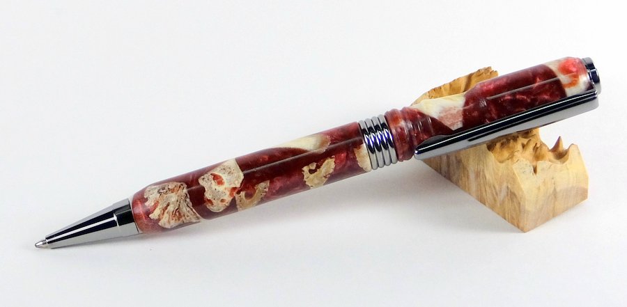

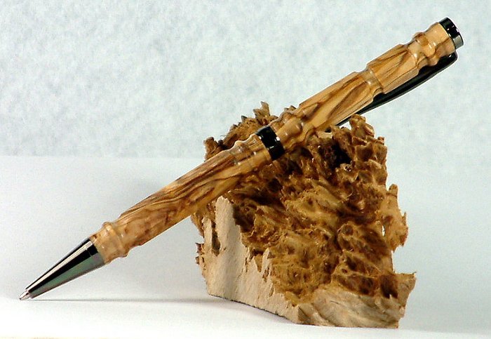

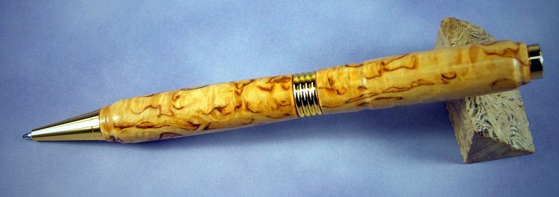

Back again. My set up using two sets of punches metric and imperial to hold the blank in the drill chuck. Couple of larger centre bands.Couple of standard centre bands.
Cheers mate Peter.
