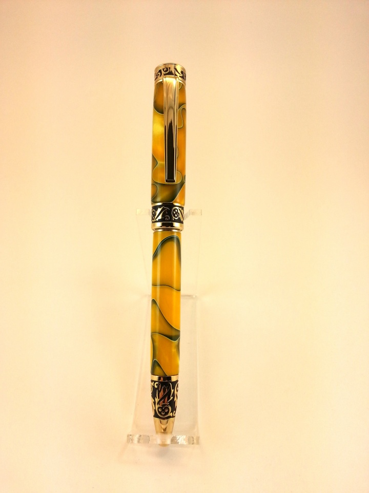

A good friend purchased several pens from me and another several for o her friends at work. As a way to express my gratitude, I asked her to pick out any pen she wanted and I will make it for her. She picked the PSI Sculptured pen kit (and letter opener). I order two (one as a b/u).
I am finding the cap insert to fit loosely within the tube (CA/epoxy will fix) and the coupler that joins the transmission to the lower barrel to fit loosely - again, will be remedied with glue. I am using the tube that came with the kit, but without glue these components can easily be separated by hand.
Anyone else have this experience?

Sculptured Pen Kit
It came out fine after using red loc-tite. I wouldn't expect a refund or a replacement if I was able to use the kit. I will leave my experience in a rating.
