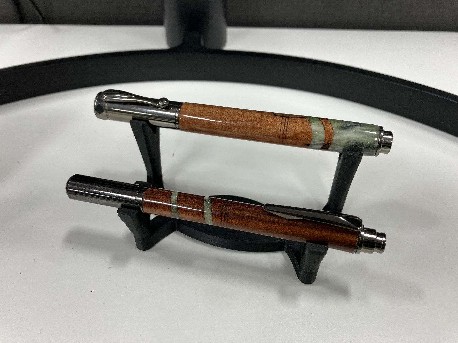

In any case, I ordered the 4-pack from PSI that comes with one kit from each plating option. I turned my first one last night. I used segments of the same diamondcast "tea tree" blank I used as an accent material on my Zen for this desk, and the rest of the blank is carob wood. Ultimately I'm not crazy about the carob wood. It's fine, but it doesn't excite me. Still, the pen came out looking quite nice.
A quick bit of 3D modeling, and I was able to print a simple 2-pen stand for each of my desks, which holds and displays the pens at slightly different heights.
So far I have a very positive first impression of the Rollester. I was nervous - a lot of the reviews and threads online about the kit spoke of alignment problems with the plastic insert, which make the lid sit cocked on the pen, or fail to post. I don't know if I've just been lucky so far (n=1 and all that), or if PSI has done some work to correct these issues. I did not have to assemble the plastic insert at all. It was already inside the cap of the pen when it arrived in the bag. Mine seems to click onto both sides of the barrel (closed/posted) just fine. It's straight. No complaints.

So having medium sized hands, you would say that it is a comfortable size too? I have friends who like the smaller, Slimline size pens and I make Slimlines for them. I prefer medium to larger kits and am just learning about Zens, which I just ordered to try out too. I'm glad to hear about the PSI model and will likely give it a try as well. Those both look great and you did an awesome job on the segmenting.
I expect you'd like the Rollester. My wife is the same as far as preferring the thinner pens. She likes a slimline or one of the modified slimlines I like to make (perhaps just a tiny bit thicker than a normal slimline). She really specifically dislikes the cigar pens I've made -- too chunky, she says, uncomfortable for her smallish hands. Kind of a shame IMO - not because slimlines are bad pens; I think they can be made to look and feel really nice. Just that the best possible refills for them (Cross-style format) fall quite a ways short of the best possible refills available in Parker style or Schmidt-type rollerball. When I knock out my next Rollester, I'll ask her to try it out for a bit and tell me how comfortable it is for her. I think it might be right in that happy medium diameter where it works well for just about anyone.
Thanks for your kind words! I find I really love segmenting, but it's deceptively difficult to do well. Some of the people on this forum are masters. I'm an enthusiastic learner. Lately I'm finding that for kit pens that use brass tubes, I'm better off drilling all the constituent blanks before I cut them, and then doing the final glue up with a 30-minute epoxy, using the brass tube as a central core around which to ensure everything is contacting well, oriented and aligned properly, and not slipping and sliding when a bit of clamp pressure is applied to get good surface contact. This approach is especially helpful when I have angled cuts like the pens pictured. Trying to glue angled pieces like this without them sliding apart has historically been devilishly hard to pull off. And it entirely sidesteps the issue of separation during drilling, which seems to be the major point at which my segmented blanks have failed in the past.

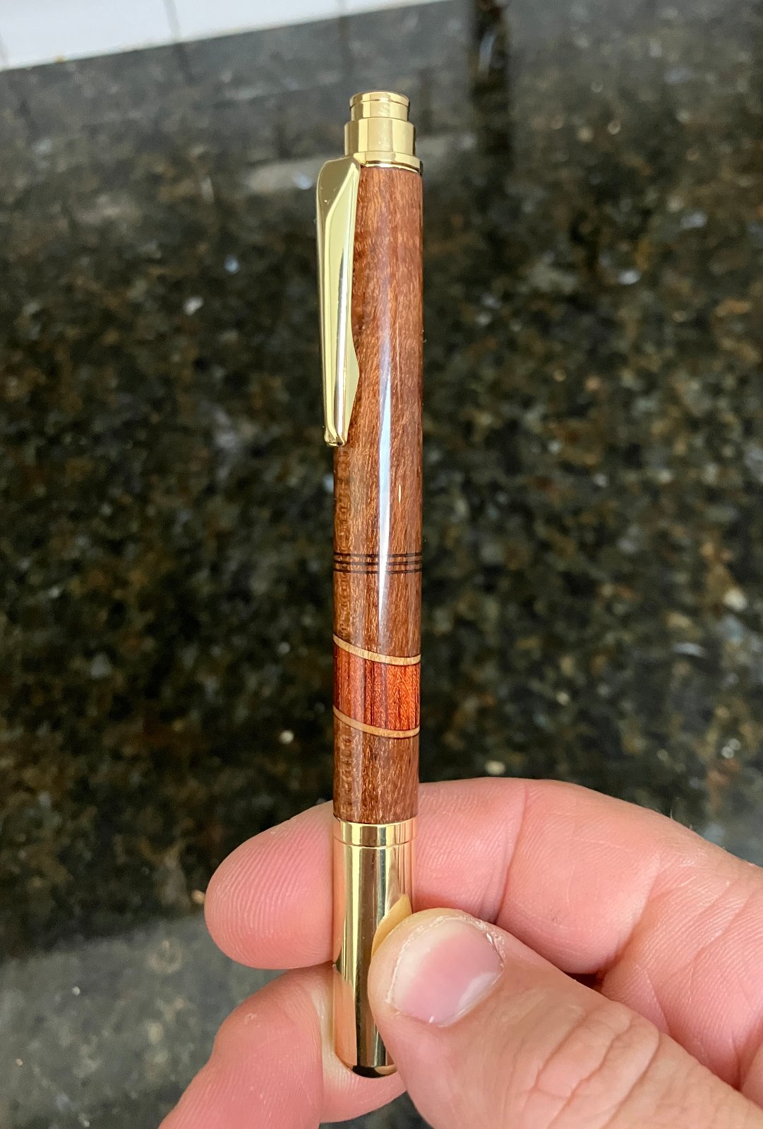

Turned another one, this time with acacia for the main barrel, a bit of bloodwood for a contrasting stripe, and very thin slices of cherry to accent. I think I did a better job on this one. The more I write with these, the more I love them. They're so easy to turn, and fantastically comfortable in the hand. Once again I have zero issues with cap straightness, and it clicks into place very convincingly on both ends of the barrel. I will absolutely be buying more of these; they're ridiculously affordable. One of the least expensive rollerball kits out there, competing for price only with the Apprentice Jr. Gentleman II from CSUSA. Haven't tried that one yet, I'm sure I will sooner or later.
But yeah. Very pleased. These will make great gifts for my friends in the office around Christmas time, I think.
