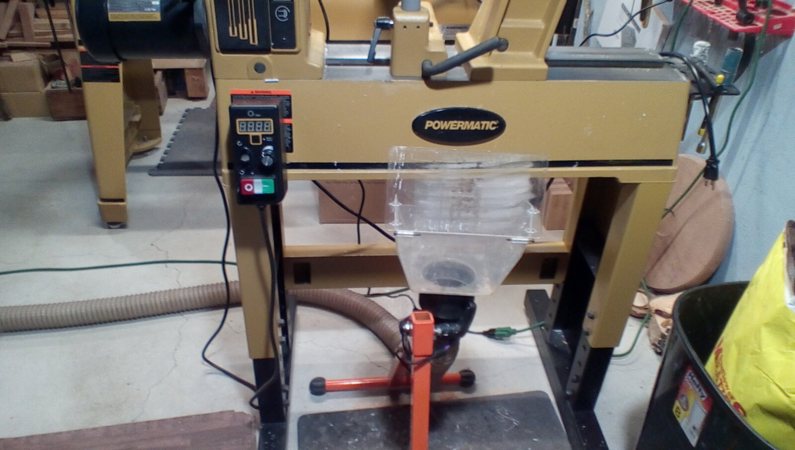

I made my own out of a stormwater T fitting. I just cut an opening down the side. It works well. I can butt the bottom side under my blank & hard up to my tool rest.. to try to capture as much as possible.

thats a really neat idea. I might try it for the acrylics ( plastics) !

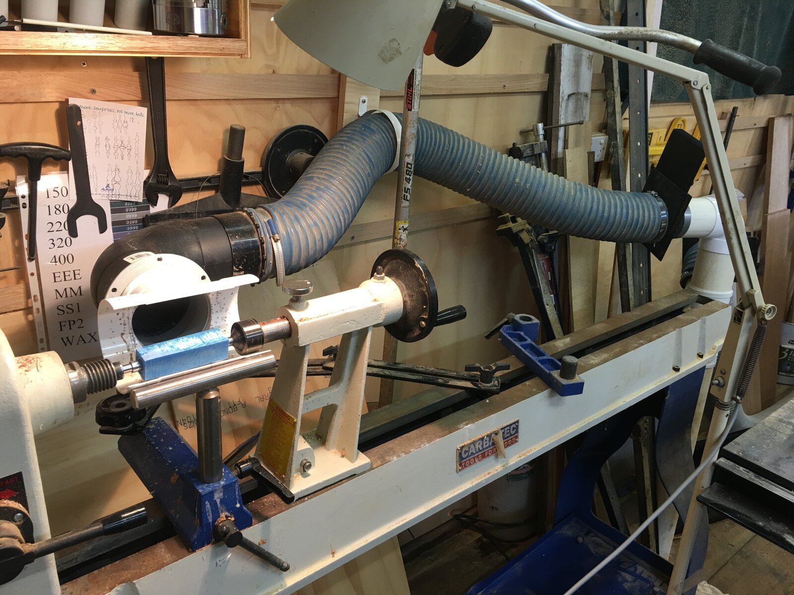

I noticed the rotation of the lathe propels most of the acrylic shavings towards me. So I fashioned the Rockler collector on a roller stand in front of the lathe connected to Dust Right separator then to the dust collector. Works great.

Thanks for that David, it's a good point.
With my current set up that would hit my gut ( expanding concern 🤫) so i'll stick with jerry rigging the hose etc behind the lathe where my stomach is not a factor.

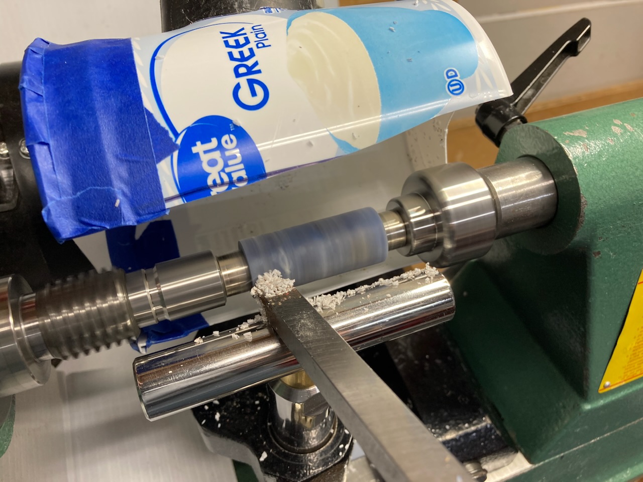

I just use a shop vac for dust collection, so I decided to fabricate a makeshift scoop after reading this. I just used a yogurt container.
Without a scoop, my shop vac collected maybe 30-50% of my chips, and then about 75% once I got it round and throwing ribbons.
With the scoop, it was 75%+ the whole way through. I will make a better one out of a clear water bottle to
Improve visibility.
Thanks for the suggestion.

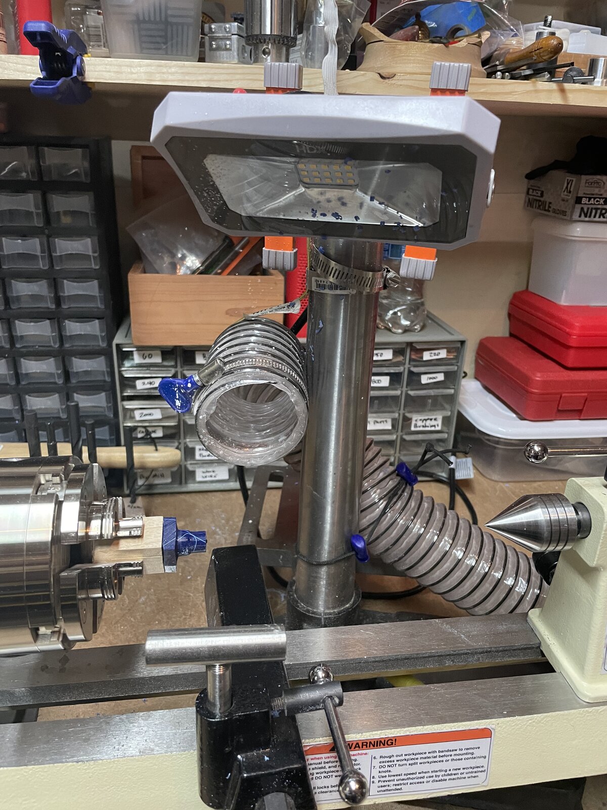

I tried using a large cut down funnel but it blocked the light too much for my liking. I have my collection hose and a light mounted to an old drill press stand that I can move around as needed. I still get a few chips thrown at my during initial cuts in acrylic but this works really well for me
Edit: I usually turn one piece at a time so not having a wider collection port isn't really an issue for me.
