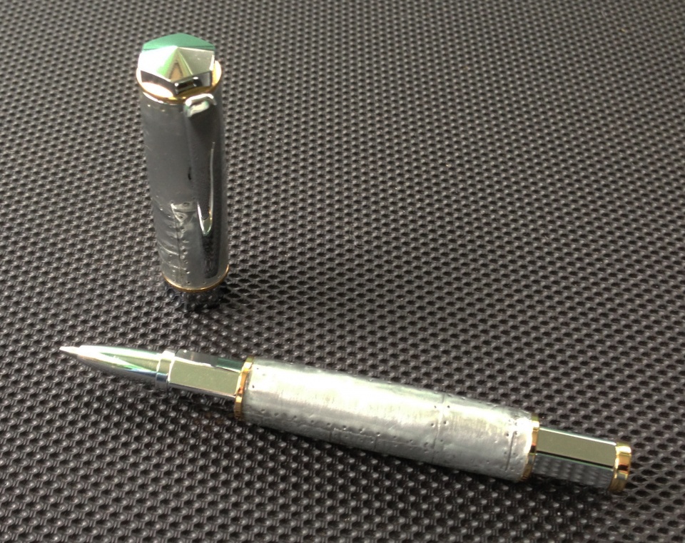

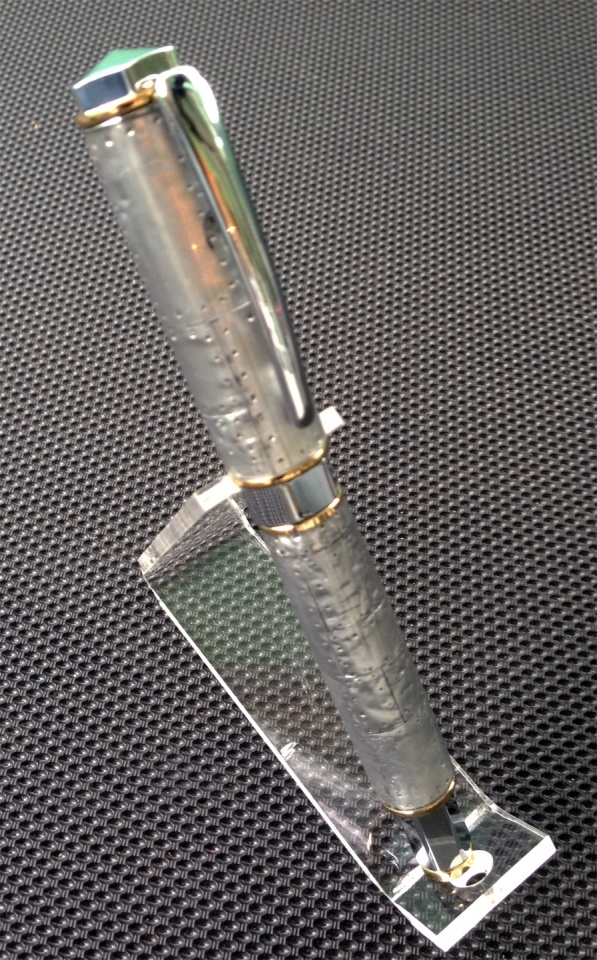

To my thinking, the balance is just a little off when posted, so I usually use mine unposted when writing. However, there is a little trick you can use to reduce the weight slightly & improve the posted balance (IMHO) -- use Jr series tubes rather than the standard Vertex tubes & a Parker bp or gel refill rather than an RB.
Here's an example - it's the pen I made for Bedangerous in our recent Steampunk PITH.
I actually got the blanks for this pen in the Pass It Forward Box #1 that came back to me at the end of the game - just in time for the PITH. Thanks to whoever made it. :smile: I thought it would be ideal for a Vertex Supreme, but the blanks were made for a Jr series - right diameter tubes, but the top blank was about 1/4" longer (no problem there) & the bottom blank about 1/2" shorter (so no way to make the RB refill fit).
After measuring though, I realized that a Parker refill would fit the altered pen perfectly, so I turned the blanks, assembled the pen & used a gel refill.
Overall, the modified pen is about 1/4" shorter than a standard Vertex Supreme, but I like the look & balance a lot better. The only downside is that it uses a Parker style refill rather than an RB, but I can't really tell much if any difference between a gel and an RB anyway, so I consider it to be a great compromise.
