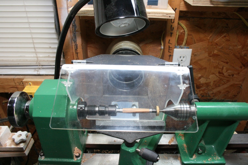

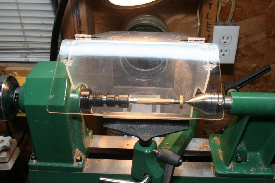

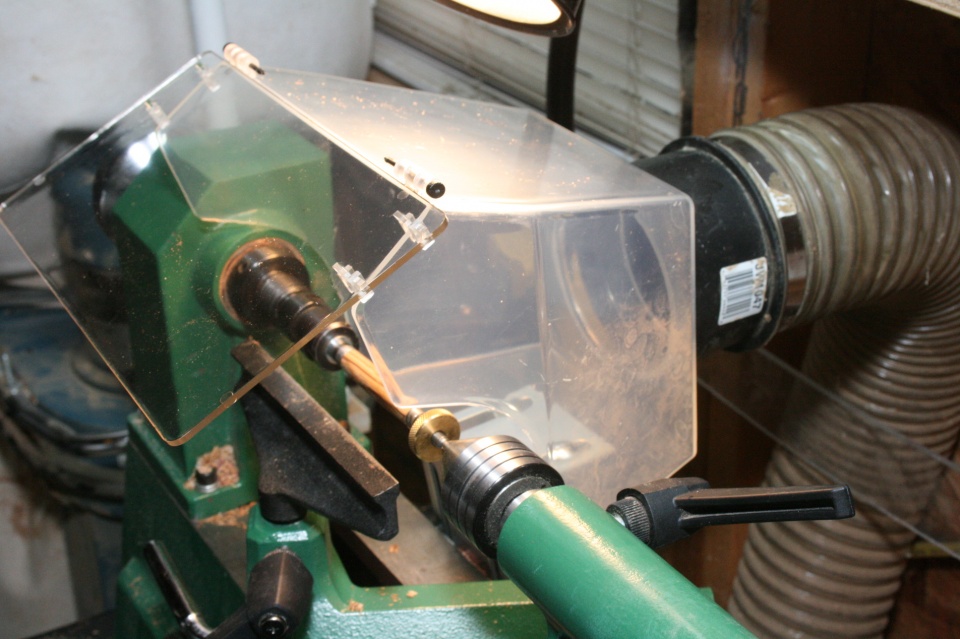

I ordered a PSI dust hood (DLHOODC2) from Amazon on Sunday and it arrived this afternoon.:smile: It took about 5 min's. to mount it. It really does a great job of sucking up about 90% of the chips.:wink: I'm been turning all my pens one barrel at a time BTC or on a mandrel for a while now so I cant say how well it would work with two barrels on a mandrel, but I feel it would work as well. This dust hood has a magnetic mounting clip which hold very securely to my HF lathe. It sell for $27.49 on Amazon and it's prime. It was money well spent.:smile:

I have had one for some time now. Got of amazon. However...it stated magnitic mounting, but mine is not magnitic at all. I have placed a few magnets on it myself. Did yours come with a megnetic mounting?

Isak; yes mine did have the magnetic mount and it holds securely.
It appears that I got short ended...:mad:.it still works with my own magnets

It does a good job with my dust collector, The chip shield flips up so you can easily sand and finish. I don't have a shop vac so I cant say for sure how it will work with one. There are plans on line for encloses for shop vac's
The only issue I've ever had with the shield is when I wet sand acrylics. It does get splattered. It just needs to be wiped down good after sanding; other than that, it is fairly inexpensive and does work very well.
This dust collection hood works well for me (Harbor Freight dust collector).
