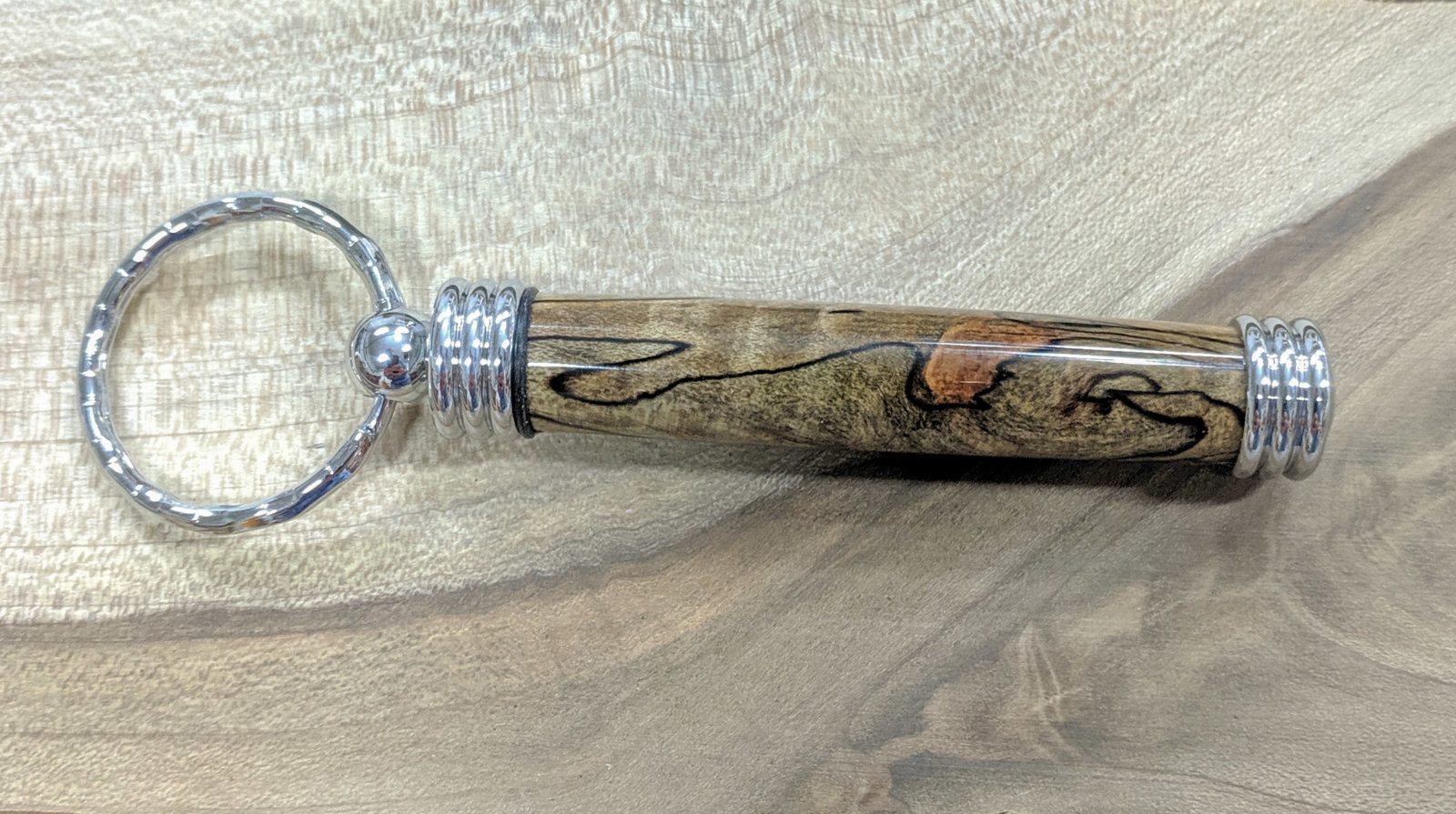

I looked up the bushing diameter on PSI website (PKSECRETC) and turned to those dimensions. I measured with calipers before starting and the diameter seemed a little small, the diameter at the endcap didn't seem important but the importance at the threaded end was less clear. I decided to go with the specified diameter (0.450) with a slight bulge. I'm not disappointed with the look, but the O-ring seems a little wonky. It bulges out unevenly and doesn't look the best. I wonder if it will be fine without the O-ring or if it will tend to unscrew on its own (obviously without an O-ring there will be greater risk of moisture issues). I have a few more of these in-progress, so I am wondering if a larger diameter will work better with the O-ring. Any advice or suggestions?
The wood is spalted Magnolia that I collected from alongside the road on my way home from work (the spalting was unintentional but somehow worked out perfectly)

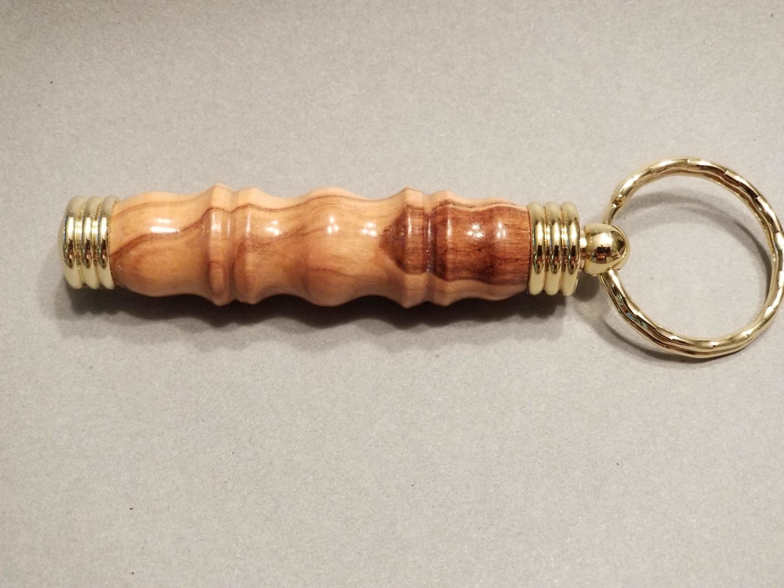

I found this customer photo on PSI's website. It looks a lot like what I have going on. Even with the slightly larger diameter at the ends the o-ring is still visible. I am thinking something like Ken suggests (with a slightly larger diameter) is probably the best. I will give it a try and see what happens.

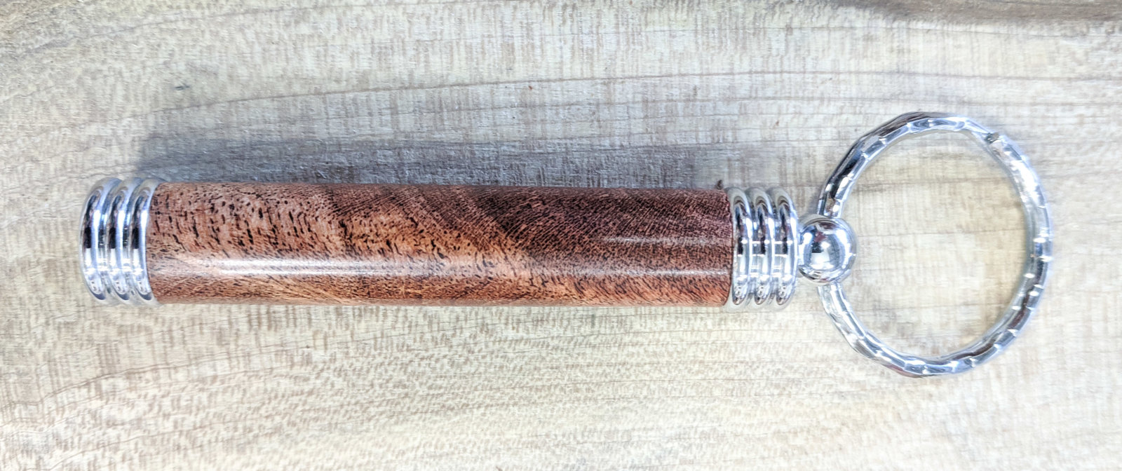

For this one I turned to 0.495 versus the specified 0.450. on assembly I left a small gap between the threads and the blank. It appears that the threaded couplers that I got do not have a groove for the O-ring. It seems possible that mine came with the wrong coupler (the whistle version doesn't have a groove). I decided use a little blue threadlock during assembly to keep things secure. I also champferred the fittings by mounting in my 4-jaw chuck using pin jaws and my skew, was pretty simple. I like the fit better at this diameter and the O-ring seems to be doing its job.
This time in mesquite with wax finish.
