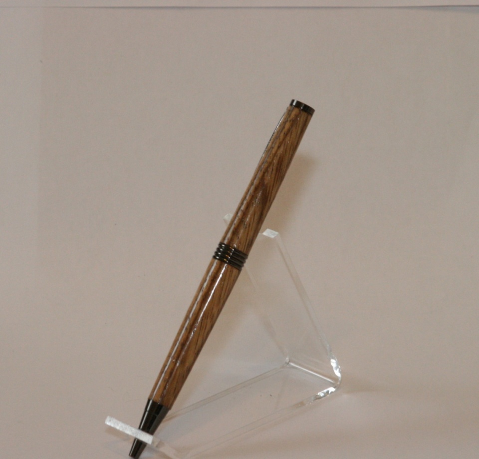

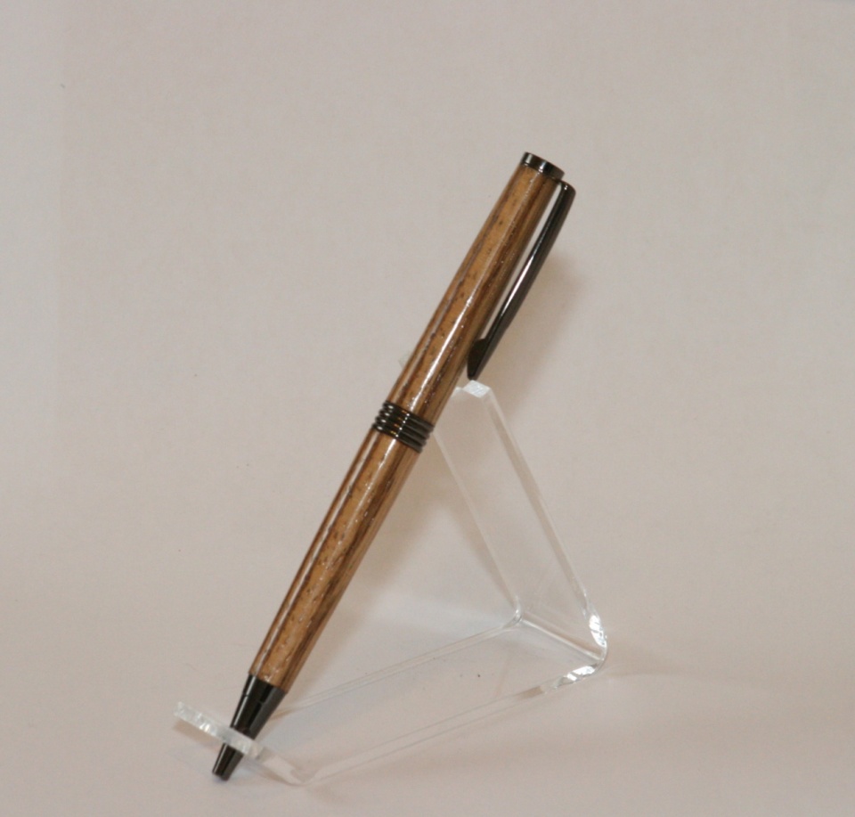

Here is the first pen I've turned in a while. Evelyn has a number of my pen but most are bigger then she likes. I told her I had trimline kits that I'm sure she would like. I had her pick out a blank and she chose a Zebrawood blank from group she got me for Christmas she also picked out the gun metal finish kits. I think she had a good choose of blank and kit. The finish is WTF. This pen took a while to make as I cant move very fast on crutch's. I'm happy on how it came out. As always any and all comments are welcome.

That is dedication....chasing the lathe around on a crutch!
I just used some WTF today....very cool stuff. I can see you had good results from it too!!!

Thanks for the nice comments. I'm getting better at turning while I'm setting. SDB777 I know your going to like using WTF a lot on most of my projects I use 4 coats wait about 2 min. then sand with 3600 MM I follow that with 6 to 7 more coats and after about 30 min if I'm a hurry or about 3 hours to the next day if I'm not then I polish from 6000 to 12000 MM. Some folks may say I put to much time in to finishing. I think it well worth it in the final product.

Excellent Fit and Finish, to a Great Blank, and Kit.

Nice pen Dan. I like the simple classic look of a functional wood pen. Looks like you nailed the fit and finish execution. I'll have to look into trying the trimline kit!

Neat looking pen
It matters not how long it took........And the finish is what 'makes' the pen in the final product. How can anyone say you put to much into something that makes you feel great?
