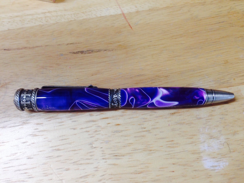

I just finished and assembled my first PSI Failth Hope and love pen and the nib barrel is too short! I didn't shorten the tube as it still measures 2.119". the point sticks out far enough that you can write with the tip retracted, and I'm sure this isn't a good thing if the pen is in a pocket.
That is the good news. The bad news is that I have already glued up and preped 7 more kits. :frown:
Anyone had this happen to them? Suggestions from anyone???

Hmm .... yeah, that does kinda make it tough...
Looks like the screw-up is all on them. I hope you can salvage your blanks... :(
