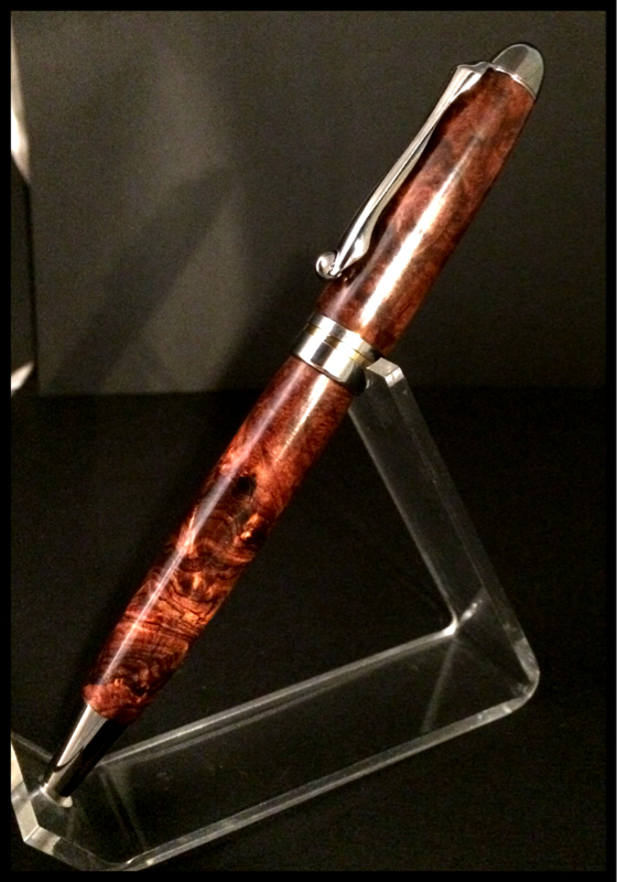

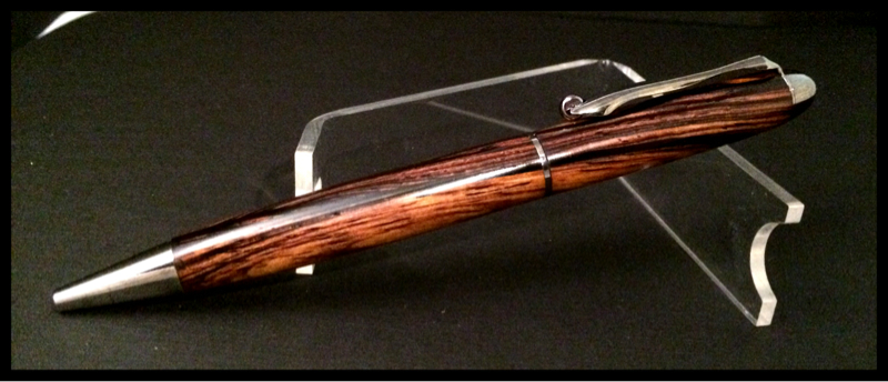

I like this Neopean from laulau. I also made one without the cap centerband and it's even slimmer.

Dan thanks for the mention of the Neopean from Lau lau. That is exactly the pen I'm looking for and if these pens weren't just casual gifts I would get some kits for sure.
