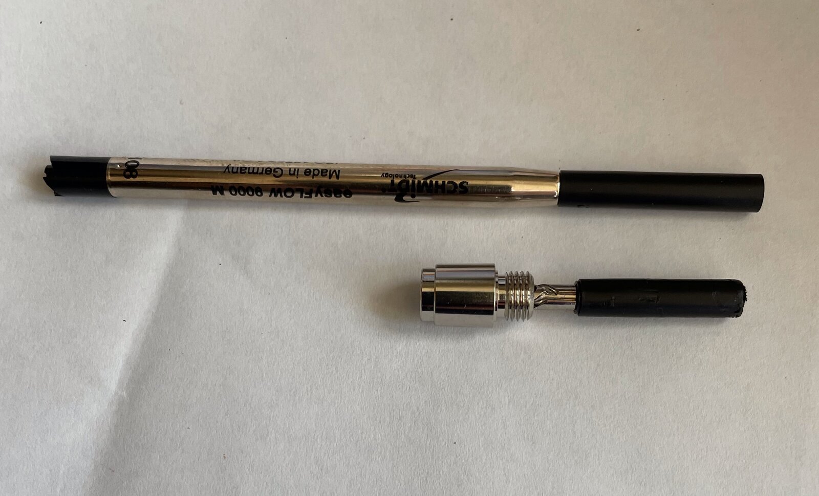

Like many others, I don't like the plastic refill extender that comes with the EDC Duraclick. Too easy to loose in my opinion. I found an easy to make replacement. The Schmidt Easyflow 9000 refills from ExoticBlanks come with a black cap, I guess to protect the tip. Simply drill it out to 9/64" and cut it to length, approx. 21mm. Push it all the way onto the clicker until it touches the clip.
Pack rat that I am, I have quite a few of the caps.
Clever!
Sweet! I have one of these prepped and ready to toss on the lathe. Those extensions are too easy to lose or toss. Whoever came up with that idea... grr. Thanks for this tip!
