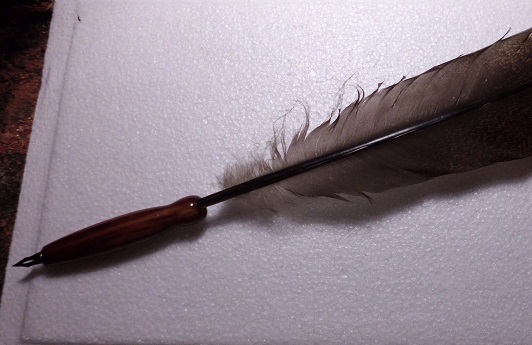

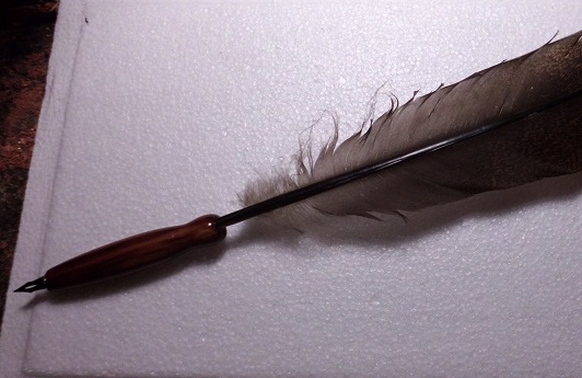

An overview of the pen .... about half of the feather is shown.

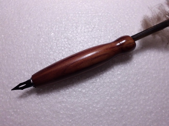

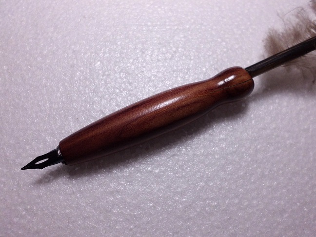

A close-up of the handle section ... approx 3.5 inches long, including the length of the nib.

Gregory I think the nib should be in the end where the feather is. That looks like the grip end to me. I could be wrong. But that doesn't solve the sharpness issue.
Lol ... that deep rounded depression is where the web of the first finger and thumb rest .... the pen is very short.
You can imagine that rounded nub as the center band of a pen, and then you'll understand it a little better. :)
The rounded nub is only there to serve as a holding attachment that holds the feather in place ... the hole drilled through it is off-center and only 3/32nds. There is a bamboo skewer section, about an inch long, buried in the end of the feather and into the back of the pen that serves as an anchor to keep the feather in place.
