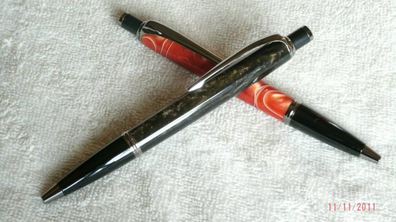

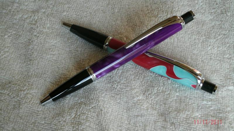

Just finished 4 Compson kits and thought I share a couple pics and some observations.
Likes:
1 - It's a click style pen (personal preference).
2 - The styling is good. I esp like the sculpted clip. It sits in a shirt pocket just fine. I also like the beaded center band as opposed to the "machine etched" style you see on most pens in this price range (and above).
3 - This relates to style - not too big, not too small. Nice ergonomics/balance - feels good in the hand. Should appeal to both men and women.
4 - Assembly couldn't get much easier. It'll be hard to screw this one up.
5 - Parker-style refill.
6 - Price - They start under $7.
7 - 3 finishes (chrome, blk T/N & gold T/N).
Dislikes:
1 - The guage of the stamped clip seems a little on the thin side
2 - The black plastic tip pushes this toward darker body blanks - either wood or (esp) plastic. See the pics.
3 - I may be getting REAL picky here. Although I like the styling, I wonder if it might be too "vanilla" to sell well. I have my first show this weekend. These 4 will be there. We'll see.

Thank you for the review. I received my catalog the other day and those caught my eye because of the clean lines. How long is the tube? Looks like PSI got this one right.
Feb 25, 2010
1,800
webberville, mi
Christopher - Didn't measure the tube but the overall length of the pen is about 5 1/4". Nice, also that this is a 3/8" tube - they're available everywhere.

having done a few shows i have a feeling that that purple bodied pen will not be on teh table long. some advice, who am i to give advice), in most mid range venues anyway, purple is one of the most popular colors you can carry. good luck on your show and let us know how you do.
