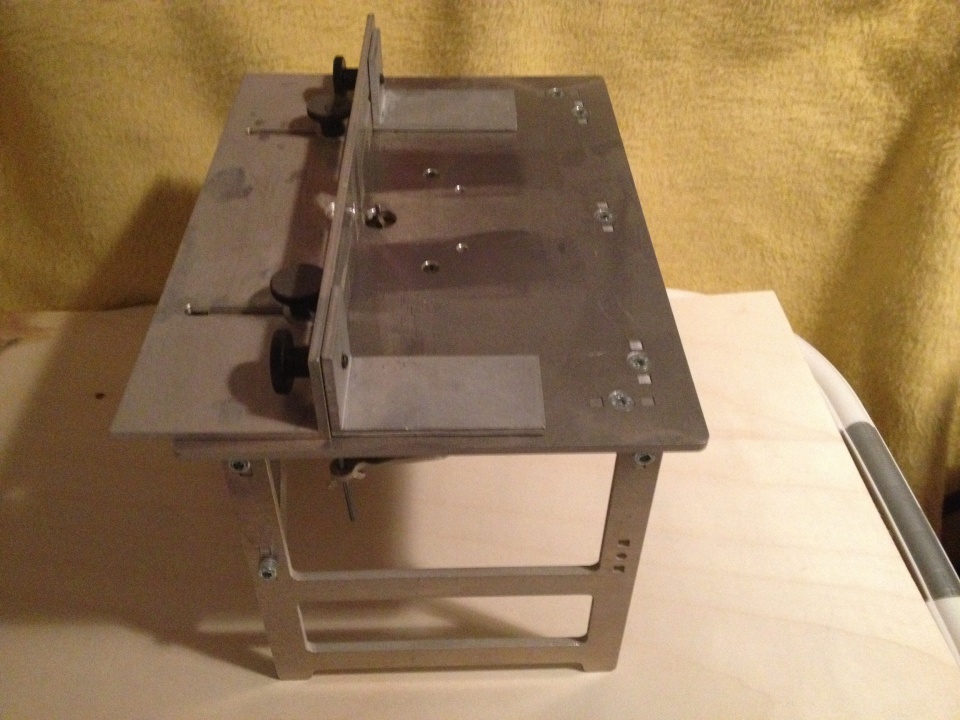

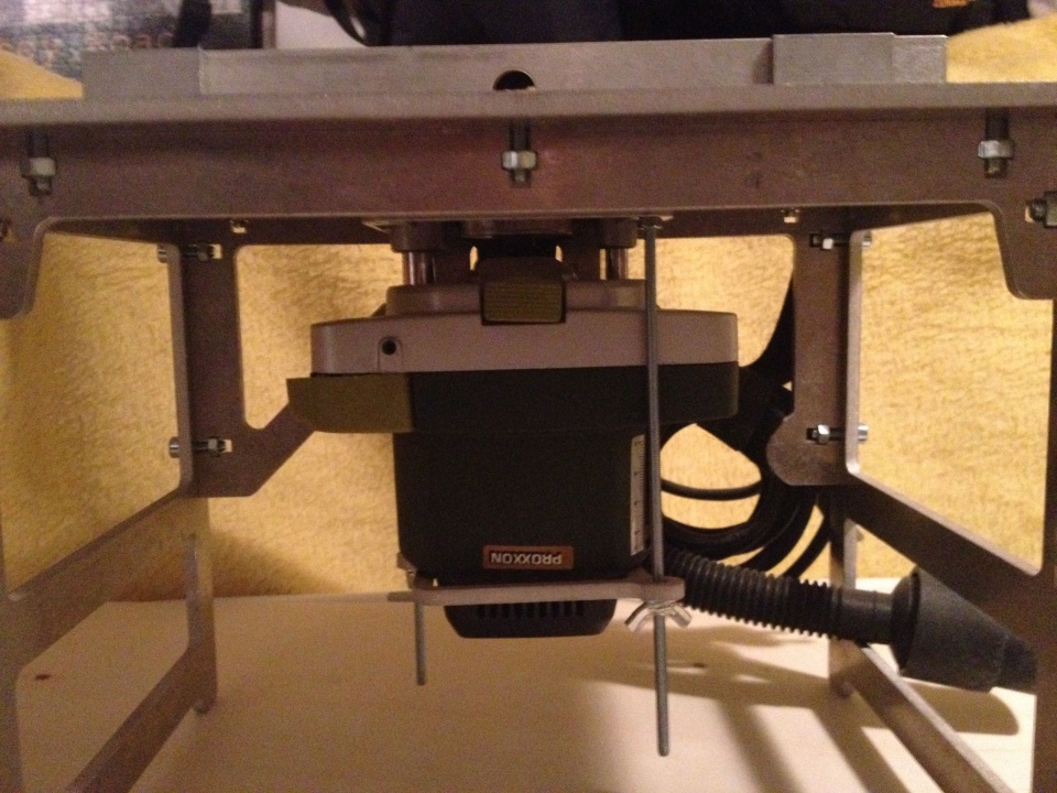

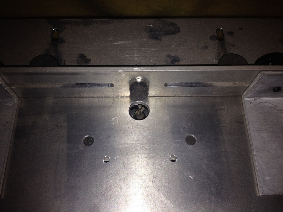

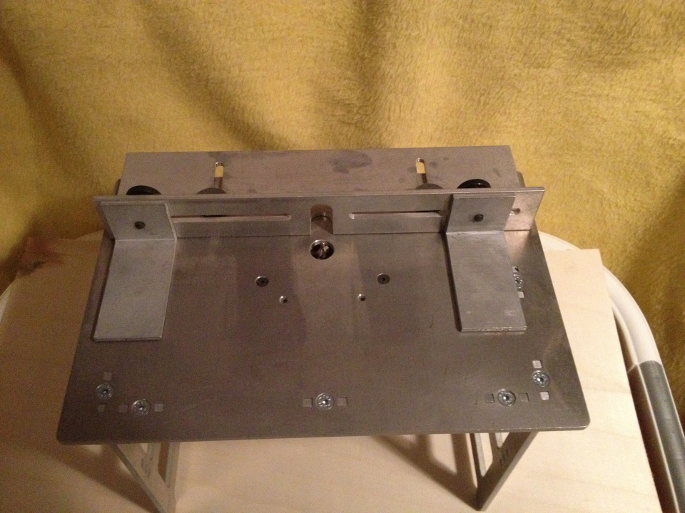

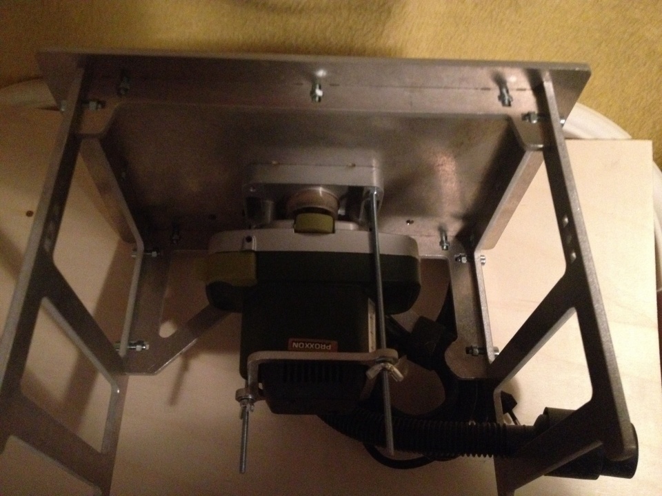

I have made a small table for the MICRO Router. The main parts are water-cut out of hard Aluminium.
If anybody would like the plans, Drawing as PDF, Watercut as DXF, please let me know and I will mail them, free of charge of course, to you.
