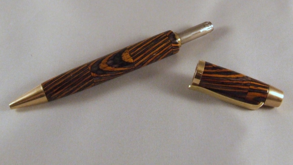

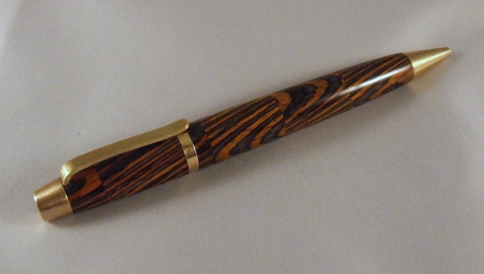

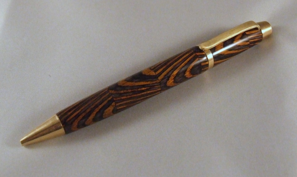

Just completed these.
Twist pen. Sierra transmission, built up on at least 3 different diameters of brass tube (I lost count!). Nib and finial turned from brass rod (playing with my new mini metal lathe) and clip hand made from brass sheet (a tedious filing and sanding job - and it's not perfect). I need to summon up the patience to have another go.

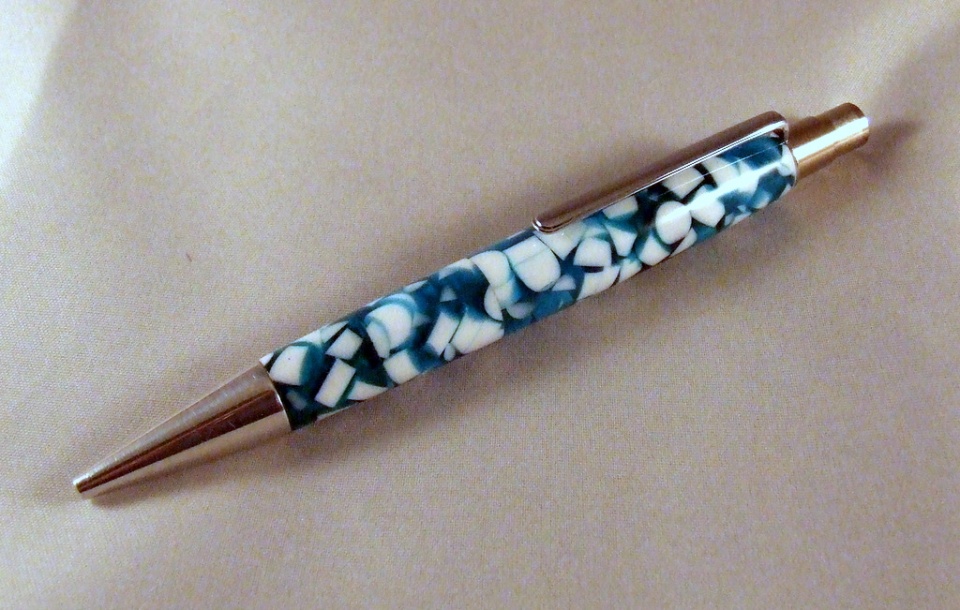

Click pen. Schmidt mechanism and turned aluminium nib. The mechanism behaves oddly with intermittent reluctance to function. I took it apart but could see nothing obvious - perhaps someone else has experienced this.

As a fan of good click pens, I really like the click pen. That is a very good job on the nib. I don't think many have done one that tapered. Most (including mine), have a little roundness to them just to be safe with the wall thickness. :good:
The taper was turned on my mini metal lathe using the top slide (compound slide). First I drilled the metal to the three different diameters and depths which I have noted down. After doing the taper I use a collet chuck in my wood lathe to hold the nib by its tenon and then "tweak" the final length and maybe the profile of the very end using an hss "3 point" tool which I made.

Great effort overall!
Making a clip for our kitless pens presents a lot of challenges, including getting a good looking shape, along with establishing the required "spring action" so the clip does not bend out the first time it is used. You did not back off from the challenge. Nice work!
Thanks Steve. I did a bit of reading about other peoples experiences and then decided I simply had to make the effort. Fortunately I actually enjoy experimenting and learning new skills. :smile:
