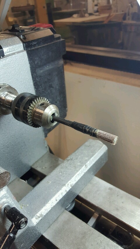

After a few issues with cracking blanks while pressing parts together, I tried a few things. The best way that I found was to reduce the inside diameter of the brass tube. (Sanding the male pen parts causes way to much risk of damaging the plating.)
Sure, a Dremel can do the job, but the wheels are expensive, and they need to be replaced often. I wanted a solution that I could repeat quickly and with a low cost.

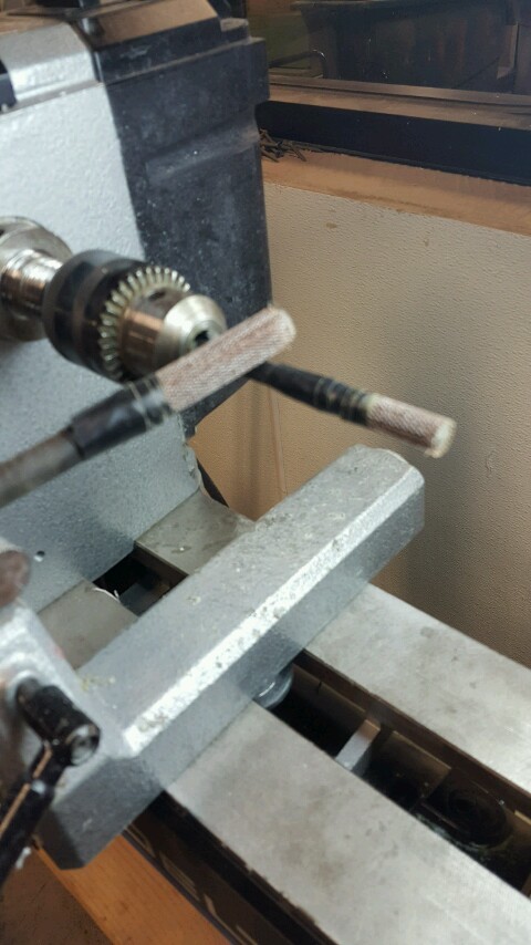

Using a transfer punch and a small piece of Abranet (I'm using 120 grit, because that's what I have on hand) I can abrade enough of the brass to create a slip fit for the pen parts quickly. I mount it in a jacobs chuck.
After testing the idea, the best way I have found is to take an inch wide strip of Abranet and taping the first 1/4" to the punch, wrapping it carefully in the direction it will spin. Wrap it around a couple of layers thick, I use electrical tape to attach it to the punch. Be careful that there is no overhang Abranet, make the end flush with the punch.
I found that having a couple of punches set up in different diameters can cover most of the pens I make. My next step is to get a second set of transfer punches and prepare a few sanders so I can quickly switch them out as the Abranet wears.

you could also take a 1/4 dowel of aluminum or brass and cut a 1 inch deep slit in the end with a hack saw and make a sanding mandrel. Lets you change out grits easily and you just tear off the worn ends as needed.

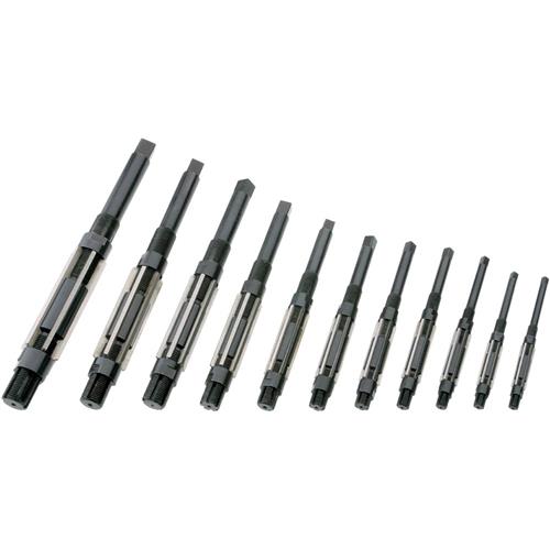

Chris, another way to remove metal from the inside of the tube is to use an adjustable reamer. I have been using these for a couple of years now. I started using this technique when I had a problem with some 30 Caliber Bolt Action blanks breaking during assembly due to excessive plating on the male parts, especially for the gold plating.
The reamers are not overly expensive. I buy them individually ($20) and in sets ($80), from KBCtools.com
If you are not sure what I mean, here is a link. Grizzly sells them in different size sets and maybe individually.
Shop our H5942 - 11 pc. Adjustable Reamer Set at Grizzly.com

I haven't tried this type of method yet .... the only blanks that have given me any trouble at all were my alabaster ones cracking during assembly.
I'll certainly have to remember the tip with the aluminum rod and strip of abranet or sandpaper... I'm sure that will do wonders for me! :)

Chris, I have been using nearly the same solution to this problem for a year or two, but never thought to post it up here as you have done. Thanks for getting the idea out. Once I had bought the second set of transfer punches, I have found a number of uses for the "pick your size" rods, ready to use for dedicated tasks, without leaving "holes" in the punch set. This is a very useful idea. I do not necessarily take the tube-to-kit-part down to a slip fit. I just know that if I remove some material, I will get a fit that works.
