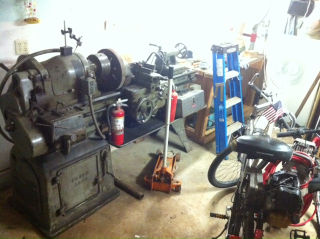

Here's mine. Trying to clean off the collection it has gathered. Hope to have it under power soon.

Just for the sake of discussion since Gofer has moved on. Cast steel as of today is $460.00 a ton. The lathe would be worth less than $300 in scrap and he would have to haul it there
Also the cost of the lathe is only the beginning. The accessories can triple the cost of the lathe or more. Ask me how I know! It really isnt in that bad of a shape rust wise. Photos tend to turn dark oil stains into red rust looking areas. I see that a lot. Most of the parts can be replaced or rebuilt but without knowing what your looking for it could be more to rebuild it than to buy a rebuilt one. Pauls is in much better shape for $500 if anyone wanted to make him an offer.:biggrin:
