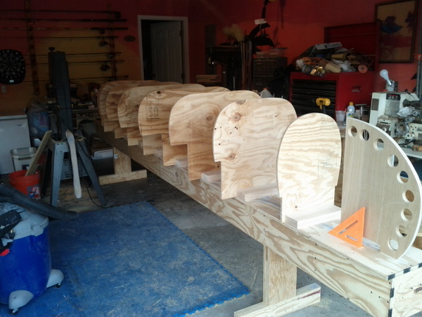

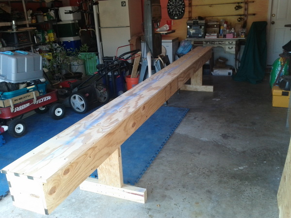

I have been wanting to build something "big" is what I have been telling my girlfriend. So my son and I will be building a 16' long cedar strip canoe. These are pics of the strong-back and the strong-back with stations temporarily attached. We are doing everything including milling our cedar strips. It will be bead and cove western red cedar with bits of mahogany thrown in. I found an old electric tea kettle today so we will be bending stems this weekend. Thanks for looking.

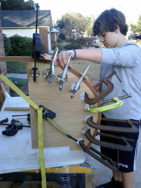

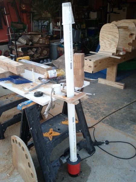

Bending the stems
Well I managed to get the stems bent for the canoe this weekend. The first picture is of my steamer, an old tea/coffee pot and a piece of pvc pipe. The second picture I asked my son to hold the stem up for pictures, he couldn't take a minute from his phone to do this as you can see. You also can see all the random clamps I have.

Coming along nicely. My setup looked alot like yours except mine was laid more horizontal and on a slight incline. Well your son is out there helping so that the main thing. Hopefully as it progresses he gets more into it and isn't quite as interested in being "glued" to his phone. lol Keep up the good work!
