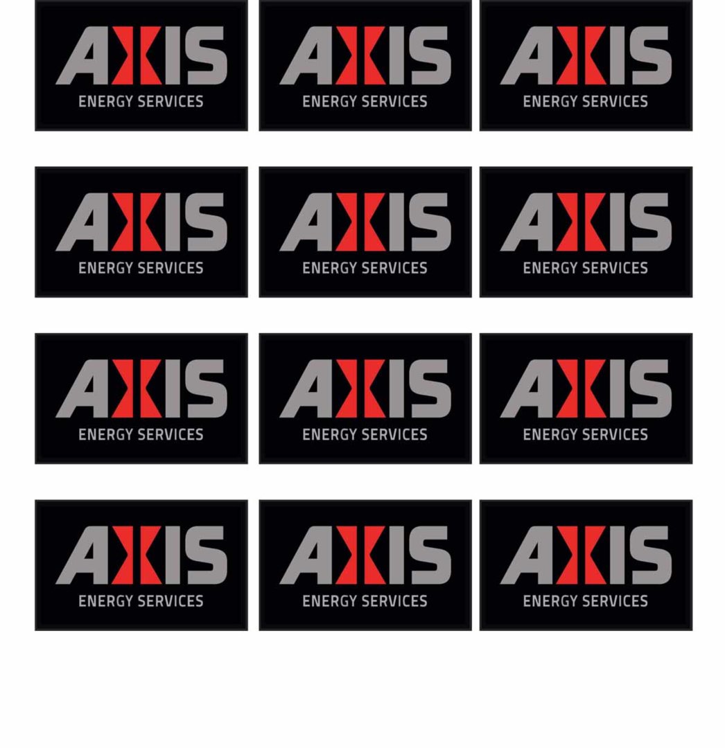

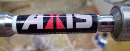

I have always tried to use a black background or at least a black border. Use a black sharpie to "paint" the overlapping edge black so the overlap does not show. Attached is a label I am currently working on for several pens. Luckily their logo was on a black background.
I build and size the art work in photoshop. Save as a jpg and drop as many images as I can onto a blank word document to print.
