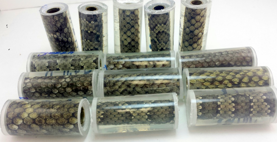

I guess if I were a snake, and had my choise of ways to be remembered, this would be my first pick. A fantastic blank, that will be turned into a beautiful pen, showing my best qualities and admired by all that see me !! And, no more worries about crossing the roads or Road Runners. Great blanks Don !!! Jim S
Thanks Jan. No, not alumilite. I cast with polyester resin which works much better for this application than alumilite.

..Nice work Don. I am guessing this was done w/Alumilite?..Be well....Jan

I was under the impression that PR would shrink away from the material it surrounds in a cast. Is this not the case?

you are correct and yes, it did shrink some.
