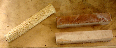

This test was planned to be on maple. But, I had a couple dried corn cobs on hand that were just begging to be stabled. So, I turned those down to get rid of soft material that would just soak up and waste the Ultraseal solution.
I put the blanks into a glass container in my paint pot, closed tight and proceeded to pull 23 inches for 45 minutes. My plan had been to pull for 30 minutes, about ten longer than recommended. But, I got distracted with another chore and they stayed in vacuum for the 45 minutes.
I released the pressure and allowed them to 'soak' for a while. Personally, I don't think this 'soaking' makes a whit of difference. If the solution didn't penetrate under pressure, it sure isn't going to all by itself.
I then took the wet blanks to our oven, which had been pre-heated to 225 degrees and let them 'cook' for nearly an hour. Note: This is a heat curing product, not an air cured or dried solution.
When I removed, there still were some fumes gassing off and I got a serious snoot full. I would not recommend you trying this. Bad news.
By the way, this version has the same 'orange' aroma as version #1 but not as pungent and it didn't linger in the kitchen as long.
After they cooled, I took a good look. The blanks, both cob and maple did not change appearance. The US #1 test considerably darkened my Redbud test blanks.
In fact, they did not look affected or changed at all. Except on the bottom where excess solution had puddled before it cured and hardened. You can see this in the attached photo.
The cobs were, no doubt, very hard even though their appearance was no different than a non-stabled cob.
OK, at this point, I still didn't know if the stable test had been successful. The solution did seem to cure as it was supposed to, unlike version #1, which, to this day, is still tacky.

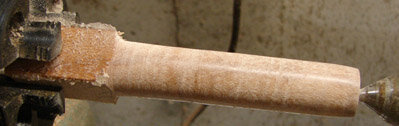

So, I chucked up one of the maple blanks and turned a portion of it to round and down a bit.
It turned OK, a bit hard but this didn't tell me anything because maple is quite hard. The appearance didn't give a clue either, just looked like maple. That is good because, if it stables as it should, you have a predictable product and your wood will look like the wood you started with.
But, I still didn't know if the stable went all the way through the wood and did it's job.
So, I sanded the turned portion. First with 220, then 320 then all the way through the Micro Mesh grits. The last few grits gave the blank a distinctive sheen. Finally, I polished with a hunk of wool blanket, a technique which may be unique to me.
The result is a fairly shiny piece of wood. It looks very good and I believe the looks are the result of the stable solution penetrating completely. But, the appearance is so identical to a non-stabled wood that I have to play it conservatively and not make a flat-out statement that the solution penetrated completely.
I even center drilled the turned blank and caught the dust on a clean piece of paper. From appearance, I still couldn't make a decision whether the solution had penetrated and I couldn't tell by feel or smell either. I tried.
Don't interpret this as me saying it did not penetrate. I simply don't know definitively. It may have and the quality of not affecting appearance (that is a good thing) is what might be the cause of the confusion.
