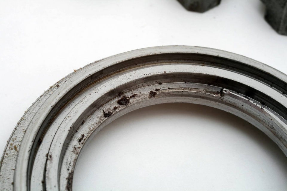

I do know for a fact, ask me HOW I know this :), that if you over tighten (both open and close positions) that it will strip the scroll ring.
Looks like this actually.
attachment.php
It will be gritty and bind in certain spots. If it's dirty then it will tend be gritty in all spots. I use brake cleaner and spray them out good, amazing what junk comes out of there to.
