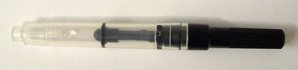

today a customer broght back his Baron FP. He uses the original ink pump with red Pelikan ink. By writing, after ca.15 minutes, suddenly the ink dont flow, the Pen doesn't write. You must the pen lay down and wait 10 minutes, then it goes on.
any ideas to the problem?

Harry, is the ink pump (converter) one of the black ones with a tiny clear "marble" in it? If so, they can be subject to somewhat of a vapor lock. Get the premium converters and the problem should go away.

There are three possible problems: the converter, the nib or the feed. If the underside of the nib is not in contact with the top side of the feed over the entire length of the feed the pen will not write as it should. That is just one other possibility, but I think the problem is probably the converter. The stock converter that Berea supplies in the kits are not very good. I have a large pile of these things because I replace every one of them with a premium Schmidt converter.

it was a new pen, bougt in Christmasweek, ink nib and converter were new. I gave the ladie a converter from the JR.s (Schmitt) and will wait...
