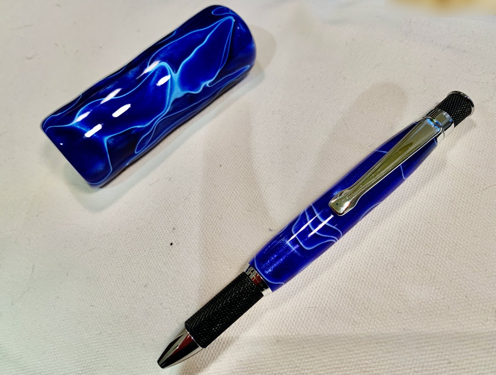

Hi folks, I made a pen to match a shift knob I made for a friend. The transmission on the PEN is so stiff that when attempting to retract the point the entire top, including the transmission unscrews. I have a second kit of the same pen (from Penn State) and it does the same thing. Is there any way to loosen it, or am I missing something? Thanks!

BTW... nice GT 's
