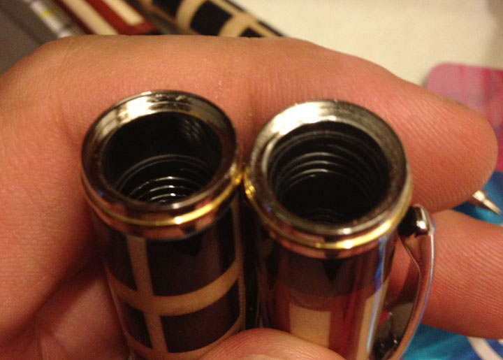

I'm having a few problems with JR. Gent II kits. So far it is by far my favorite kit. Seems a lot higher quality that a lot of the other kits out there but I've got some major issues.
1.The cap will not stay on. I carry my pen in my pants. I don't wear a shirt with a pocket. Seems like even if I tighten it tighter than I think I should, it still comes off and ruins my pants. So far I've gone through 4 pairs of pants (yes, I should have learned my lesson after the first 1 or 2 pairs.) I also don't like having to over tighten it because when I hand it to someone to look at or use, they can't figure out how to get the cap off. Can anything be done to keep this from happening?
2.The one I just did this evening, the plastic threads stripped out almost immediately after tightening it. SEE UPDATE BELOW! I do not feel like I over tightened it. I just felt it skip the threads as I tightened it. So, 2 questions. How would I go about disassembling the kit? I have a punch set. Do I need to pop the top off first? Should I ask the vendor for a replacement? Is this a known issue for these pens?

It does not appear that it is stripped. It looks like the threads are just quite a bit more recessed on this one than the other. the cap on the left is the problem, the one on the right threads properly. See photo 1 post down.

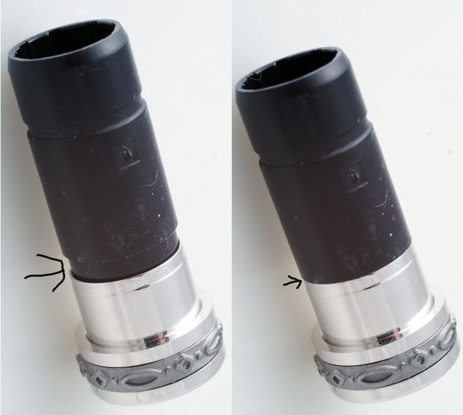

To carry it in your pants, I recommend a leather/leatherette sleeve. As for the "bad" cap, I'd think the threads may be pushed into the barrel to far. Knock off the end and see if the threads will push back in. If so, a drop of epoxy on the end of the black will help.

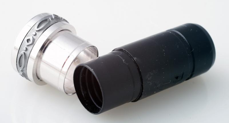

This is actually a known problem. The black plastic inside tube comes loose from the ring. What you may have to do is punch off the clip top and tap the plastic ring back down where it should be then spot glue it in place.

Got it! Popped it off and punched the plastic threads back in place. Put the cap back on the top. Doesn't look like I punched it down far enough because the postable end is still not threading. I will try again later. It does appear that the first thread got partially stripped out, as the threads have a difficult time getting started.

On the smaller section the insert rings with threads on them. There are in fact TWO thread patterns. One is deep longer, the other shallow and short. The shallow and short is the posting end while the deep and long is the nib end.
the posting end is mostly to lightly hold the cap when the pen is in use and not for storage with the cap in place as it takes nothing to remove it.
I am not shocked that the cap threads are stripped, I have even seen that ring break in half at times (most of them were trying to remove the center band)

The last time I was playing around with the plastic only section of this centerband section, I recall that there seemed to be a bit more threads then were necessary. My experimenting indicated that the nib took 1.5 turns to seat the ring into the centerband metal piece. However, it would go another half turn with the metal piece removed due to more threads in the plastic piece.
So.........maybe in this case where the first 1 or 2 threads were stripped out, one could cut back the end of the plastic and cut the stop back the same distance. If my brain can remember this the next time I have this come up, I'll try it.:biggrin:
