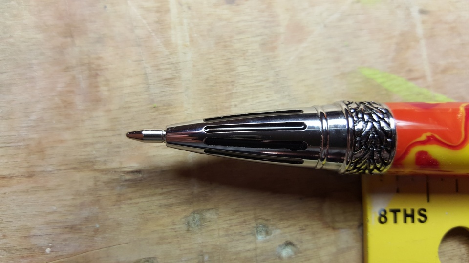

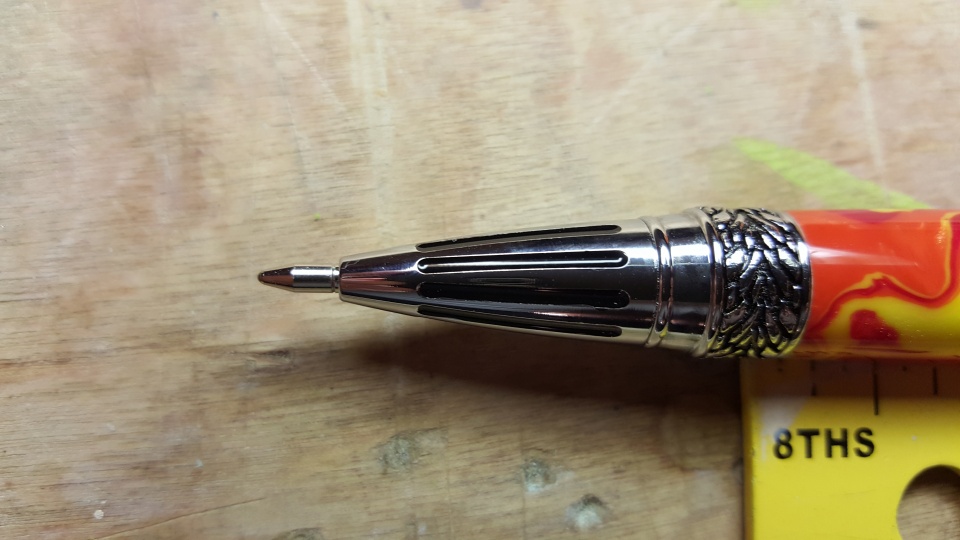

I made my first one of these tonight. When the mechanism is engaged, the refill sticks out much too far. I fiddled with it but couldn't get the refill to sit any further in the mechanism. Has anyone else had this problem, and how can I fix it?

This image shows the refill sticking out. This is when the "gearshift" on the mechanism is fully in the down position--i.e. "engaged" or open. There are three positions on the gearshift mechanism. My understanding is that when the mechanism is in the bottom-most position, that is when it is supposed to be open and used for writing. The middle position is just for show, while the top-most position is closed. (When I have this one in the middle position, the refill tip is even with the end of the cap.)
I measured the pen blank, and it came in just a hair over 2.20 inches. (Again, I have a picture with the blank next to a ruler to illustrate this, but the site won't allow me to post it.) If the tube is 2.21875 inches long, then I may have trimmed the blank slightly short. However, if you look at the picture of the refill protruding, I think there is more than just a 0.01875 inch variance in how much "extra" refill is protruding.
I have removed the refill and attempted to re-seat it numerous times, with no change to the protrusion of the refill.

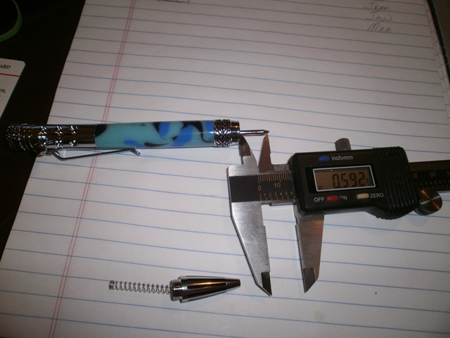

Here is a pic of the one that I have with the nib off and the gearshift in the retracted position. The refill extends approx .592 from the bottom end of the adapter. There is not any foreign matter stuck up in there, is there? When I look up in into the housing, I can see the screw that captures the gearshift handle, similar to the bolt action. No snickering about the blank, I didn't pick it out:redface:
