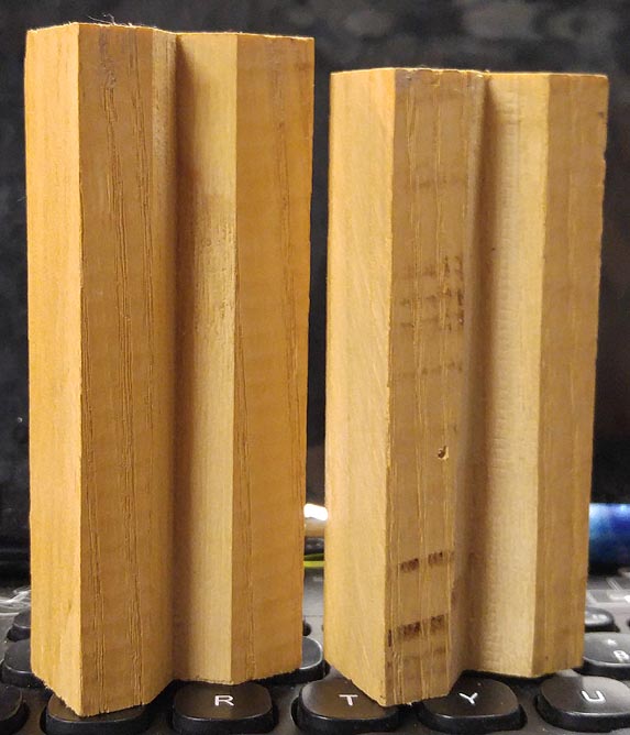

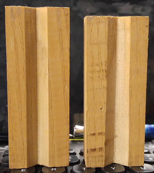

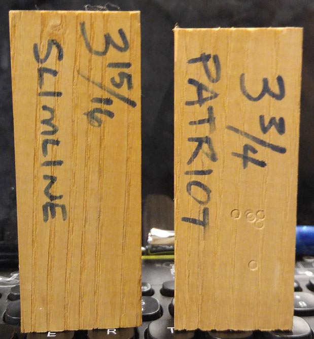

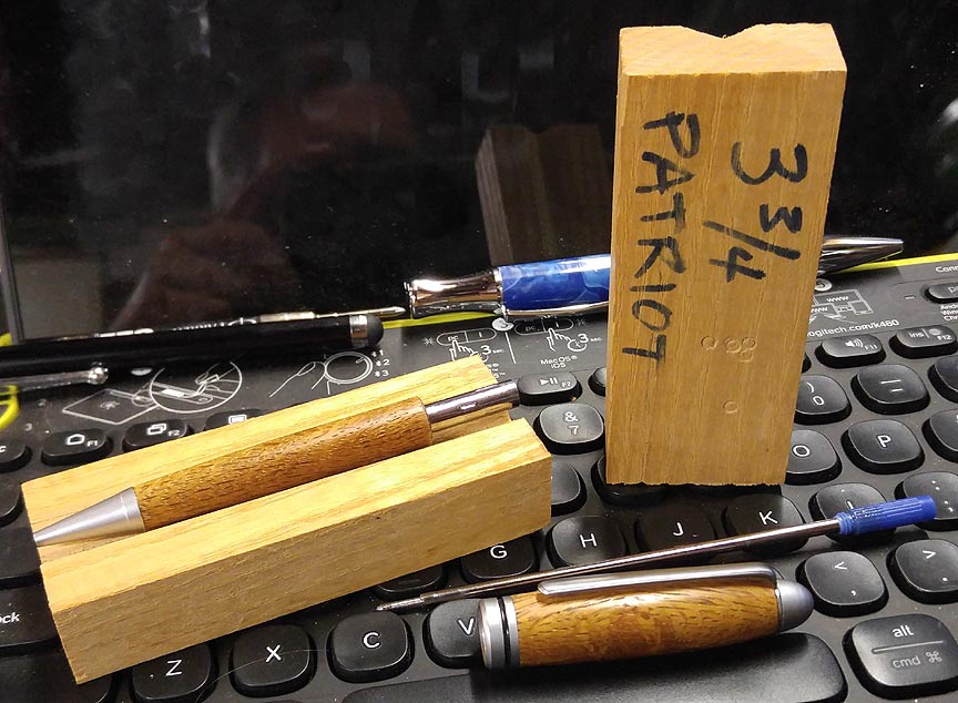

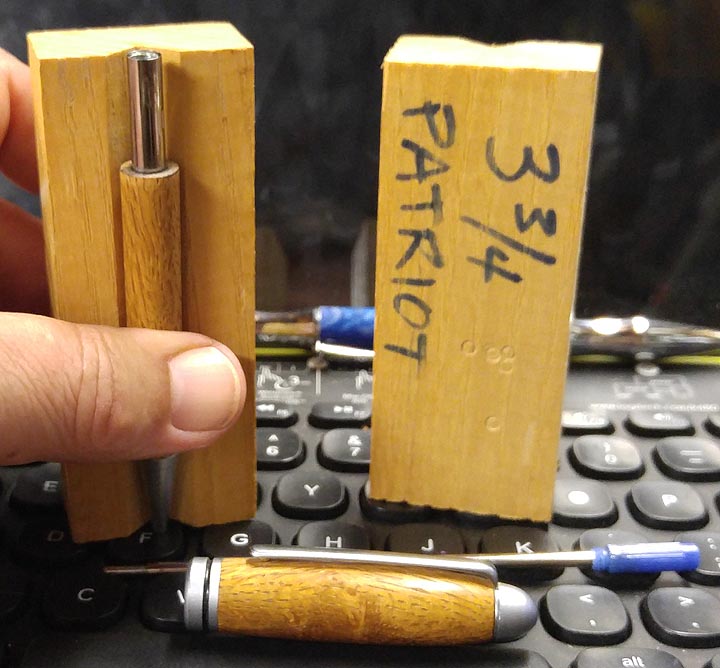

I don't turn a lot of Cross style pens these days, but when I first started turning pens, I did. Mostly various European styles. At first I did the "press it a little at a time method". Take the refill out, press the transmission in a little, put the refill back in, and check it. Repeat as necessary. I finally got tired of the tediousness, and made some guide blocks for various Cross style pens. They allowed me to press the transmission in to the correct depth at once. Worked out very well. I originally just used straight blocks, but cutting the vee's into them made it easier to hold the barrel straight while pressing.
The Summit looks like a Berea round top to me. I looked at the Summit instructions, and there was limited information on how far to press the transmission, just to the "indentation ring". The Berea instructions say to mark the transmission 7/8" from the back end. But in my experience, if you trim the barrel a little too much, you won't press the transmission in as far. Likewise, if your barrel is a little too long, for whatever reason, you'll have to press it in farther. Using a guide block eliminates the guesswork. No matter how long or short the pen barrel, it will be the same length from the tip to the top of the transmission.
