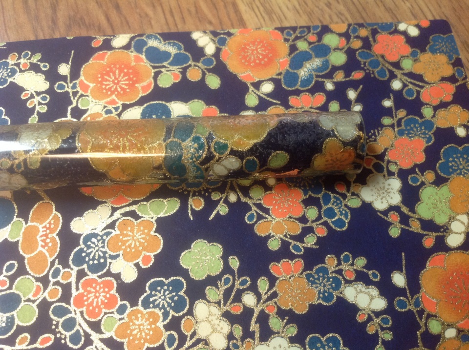

I'm trying to get on the chiyogami paper bandwagon but I have run into a problem. Some papers seem to have colors that bleach or fade after casting. Here is an example of a paper with orange colors that have faded next to the original paper.
As you can see, the dark blue background, lighter blue and green leaves haven't changed much at all. However, the orange/pink blossom colors have really faded.
I used ModPodge both to attach the paper to the tube and also give it several protective coats. I waited about 24 hours after the last coat before casting. I'm using polyester resin, 3 drops of MEKP per ounce, heated a bit before catylizing, cured in the open (fairly climate controled) air.
What are you using to coat your papers before casting? Any and all suggestions appreciated.
Woah, serious color change!

So I got my can of castin craft "Resin Saver" spray, prepared another blank identical to the one in the original post (except for the mod podge coating), and gave it a generous spray of resin saver. Will wait until tomorrow to cast and will post the results. Cross your fingers for me. :smile:

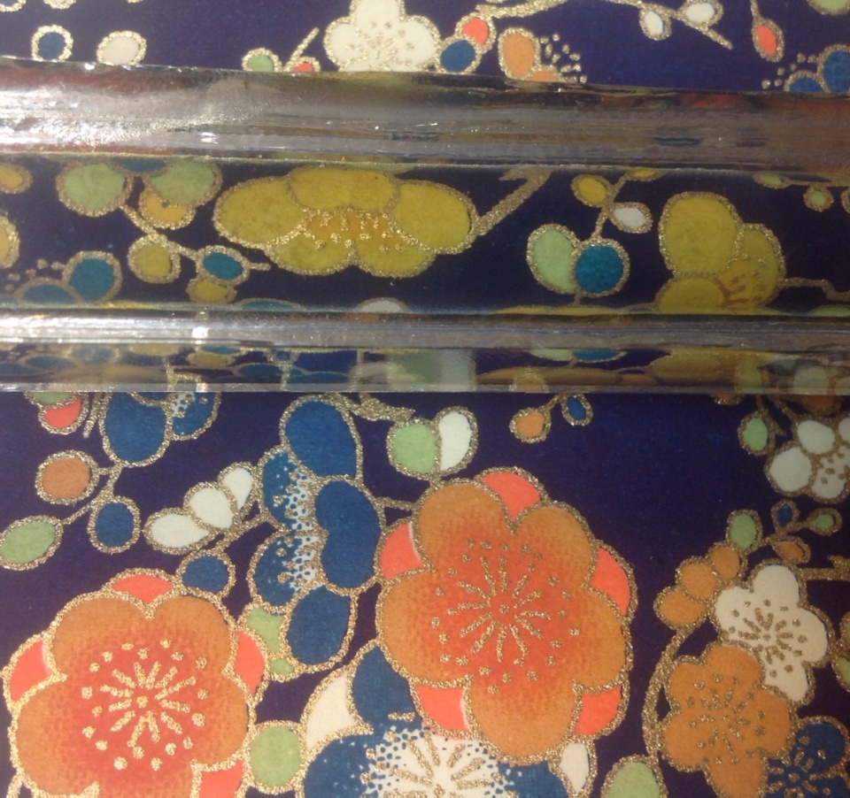

Well here is another attempt at this blank. I applied the paper with mod podge, but did not coat it with that product. I gave it two coats of castin craft resin spray, waiting a few hours in between. I cast it yesterday and just turned it.
It didn't fade to the same extent as it did before, but there was still some fading of the pink/orange colors. Also there is a crackle like effect which appears to be at the junction of the resin and paper. My best guess is it is shrinkage of the PR as it cured and pulled away from the tube a bit?:confused:
I have a new can of PR and will try that next in case it's just a case of old materials. Also I have a can of krylon clear sealer to try as well.
