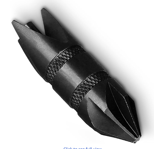

I always debur the tubes inside and out before gluing. using an RCBS crtrige deburing tool. I have gotte kits in the past with burs on the outside.
