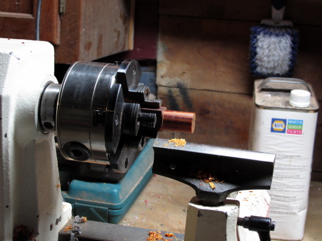

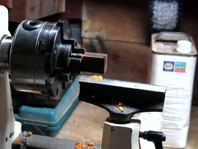

I use to have that problem when I 1st started drilling on the lathe then I started to turn a part of the blank round and the problem is solved. NowI drill blanks with a scroll chuck almost exclusively, because it works so well. What I have found is that most blanks aren't square so the scroll chuck grips the blank unevenly, resulting in poor drilling. If I turn part of the blank round and leave a shoulder to but the blank up against the blank is perfectly centered. Give it a try it works for me.
1st pic shows the piece turned round, then I turn it around and start drilling. Center bit to start, then twist bit for wood. With acrylics, center bit then smaller than needed twist bi,t then finish hole with appropriate sized bit. Dead nuts holes assuming the rest of the ducks are lined up i.e. sharp bits.

Neat idea Charlie. I have relied on the scroll jaw/pen jaws for keeping everything in line. I think your method might just be better for me.
Thanks for posting.
Gordon

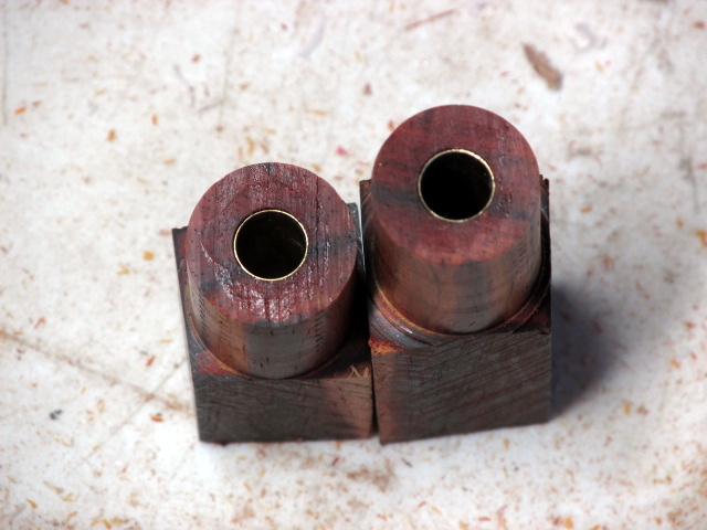

Made a huge difference in the holes I drilled for tubes, in fact it works so well I rarely use my collet chuck for drilling holes for tubes. Not sure where I got the idea from, I want to say I originally saw the technique on a bamboo fly rod building forum but I'm sure they got the idea from the bowl turners.
Ah well, I'm working on a pen tonight so I thought I'd show pics of the back side of the blanks I drilled out. The tubes are slightly recessed which creates a shadow but these holes are dead on. Plus I got one of those Canon sx170's on sale so I'm dying to use it:biggrin:
I then glue in the tubes and proceed to square the ends with a carbide cutter. With little to no slop in the drilled holes I only remove a hair of the blank to get things flush.
