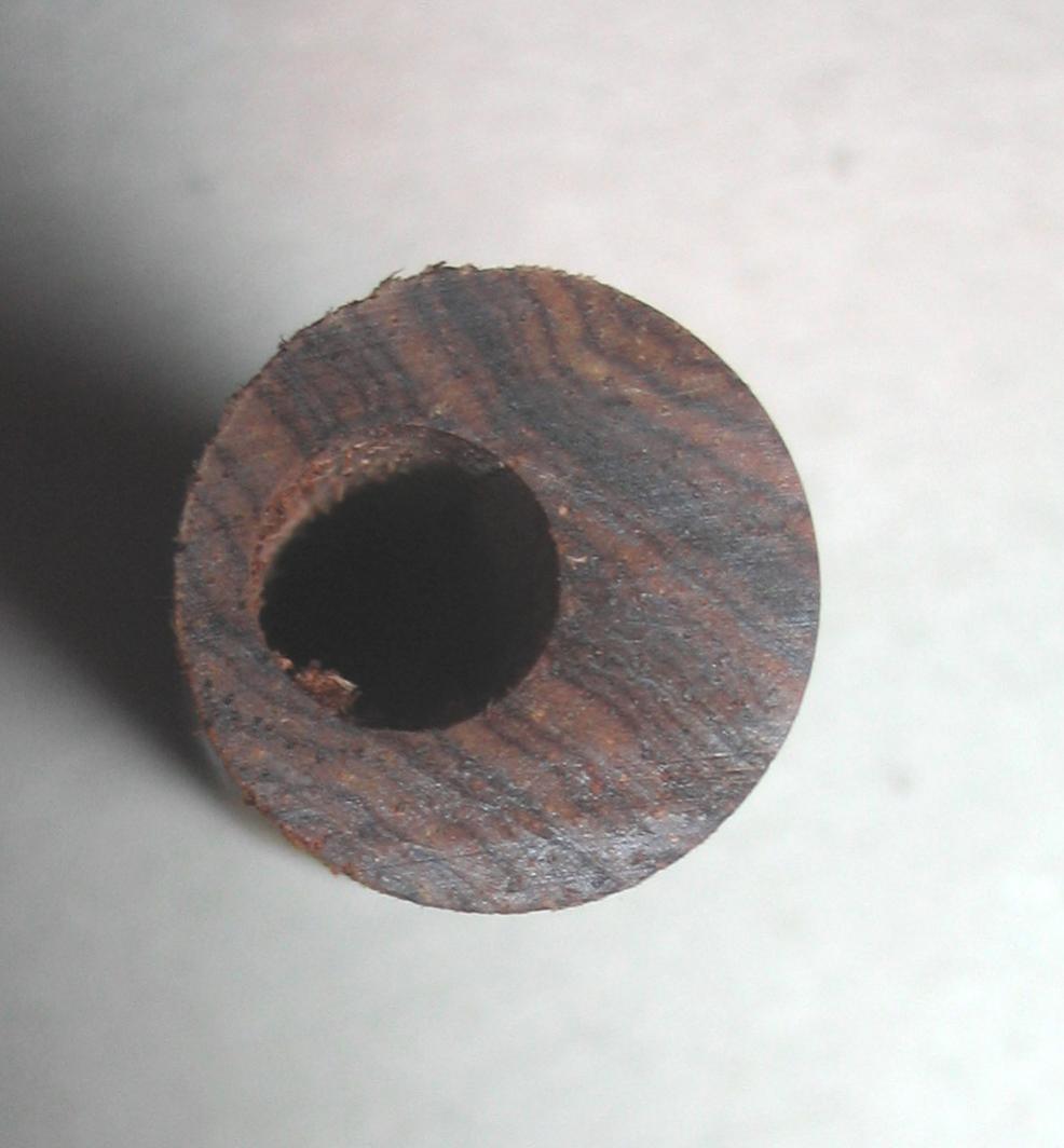

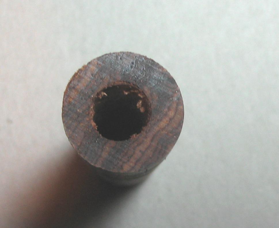

I am having difficulty getting a Cocobolo blank to drill even a closely centered hole. I'd appreciate some ideas on what I am doing wrong. The photos are opposite ends of a 2.25 inch length of 1/2" Cocobolo.
Thanks,
Herb

I'm guessing that your drill press table is not at 90 degrees to the travel of the drill bit. An easy way to check that the table is perpendicular in all axis is to chuck a piece of coat hanger in the drill chuck. Turn it 90 degrees so it is horizontal, then turn it back another 90 degrees so that it is just touching the table. Rotate the chuck by hand and as the tip of the coat hanger scribes a circle you will easily see where the table is high or low.

Two things I'd check first, and that's the drill bit and the drill press table. One flute of the bit could have gotten dull somehow, and then see if the table is square to the quill travel.

Actually, I am drilling the blanks on a lathe. It is lined up perfectly with the tailstock live center and spur center on the headstock. I turn the square blank to round, cut the 2 pieces to length and put in a Nova chuck. I drill using a drill chuck in the tailstock.
This is the first problem I have encountered boring a blank. Maybe I should try a new drill bit?

Ive had bits wander on me, especially in hard stuff like cocobolo. Bradpoint bits help and slow drilling. When I drill, I start with the blank ends that make the middle of the pen, where the two parts meet the center bands, so I know the grain line up. If the bit wander after that, its ok, because the top and bottom of most pen kit blanks are tapered and will allow you to be off center without showing.

I am going to go with the problem being the bit. Do you have a Drill Dr? Thats the first thing I would try. Maybe one flute is clogged with the wood? Try a smaller bit and see if it tracks true. If it does, then enlarge the hole with the, I am guessing, 7mm bit. Good luck!

I'm going to guess an alignment issue.
Could be something as simple as a mis-mounted jaw on the chuck (causing the blank to be mounted off-center) or dirt/grit on the threads of the chuck adapter .. (causing the chuck to be mounted off center) or could even be mis-alignment between the headstock and tailstock.
Maybe a flashlight would help .. mount the drill chuck and bit in the tailstock and shine a flashlight on it. Then put your eye up to the hole where the knockout bar goes and peer right through the tailstock. This should tell you if alignment is the problem.
Might even be a bit of sawdust buildup where the tailstock tightens to the ways. Anything that interferes with the parts lining up ..
Sometimes I'll get a slight wobble in the chuck, so I'll take it off, rotate the spindle by hand and re-mount the chuck. Sometimes the wobble goes away, sometimes not. I need to have someone make me a better adapter for the chuck .. one with tighter tolerances. The adapters we get with the chucks aren't usually all that close..
OK, those are my guesses..

Thanks for all the comments. I have it narrowed dowm to the bit. I used a new 5/16 pilot point bit in place of the 8mm bit and the bore was perfect. The brad point metric bits I have just don't seem to hold up very well.
