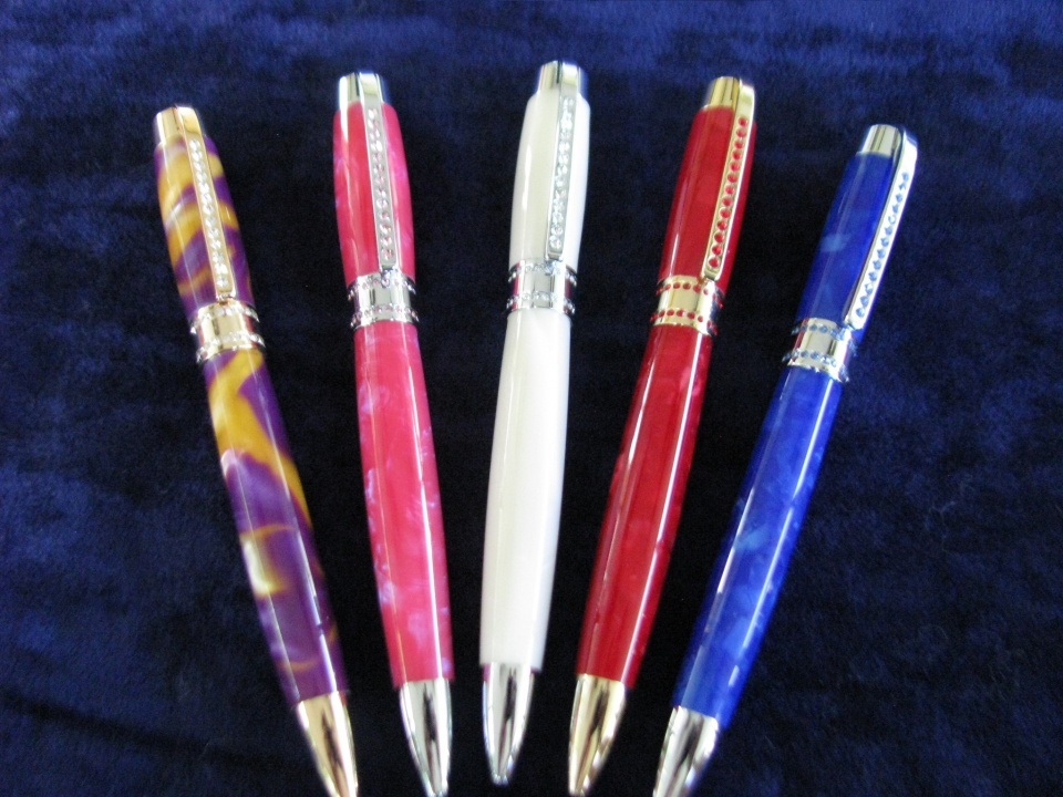

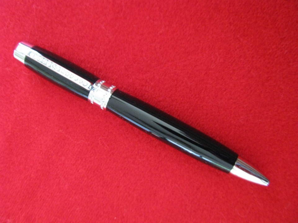

I have made several Princess pens and have not an issue with cracking. All of the Princess pens I made have been either acrylic or inlace. Before pressing any parts into a finished blank I use a counter sink bit twisted in the end by hand to chamfer the end of the tube and allow the parts to press together easier. If the tip of the cartridge is sticking out the end of the pen when retracted, you trimmed the lower section too short.

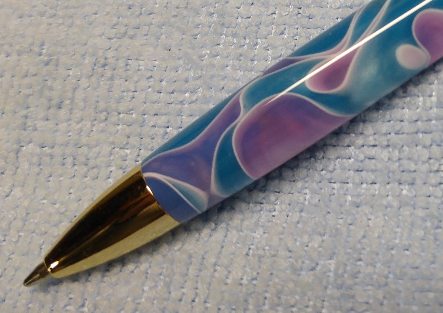

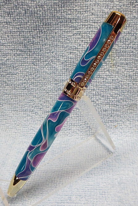

I've only ever made one, but didn't have any problems. If you're saying that the refill tip only sticks out 1/16", then that tells me either the lower tube is too long, or you didn't trim it enough. Unfortunately, the only way I know of to fix it is to disassemble the lower body, and trim it some more. Maybe someone else will have a better idea.
