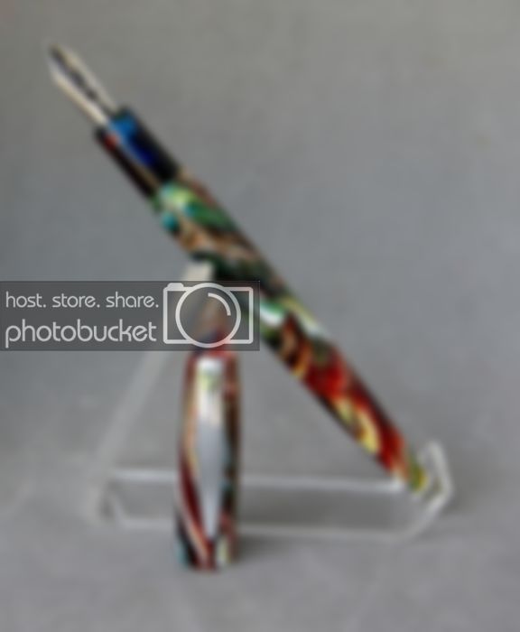

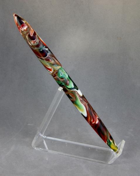

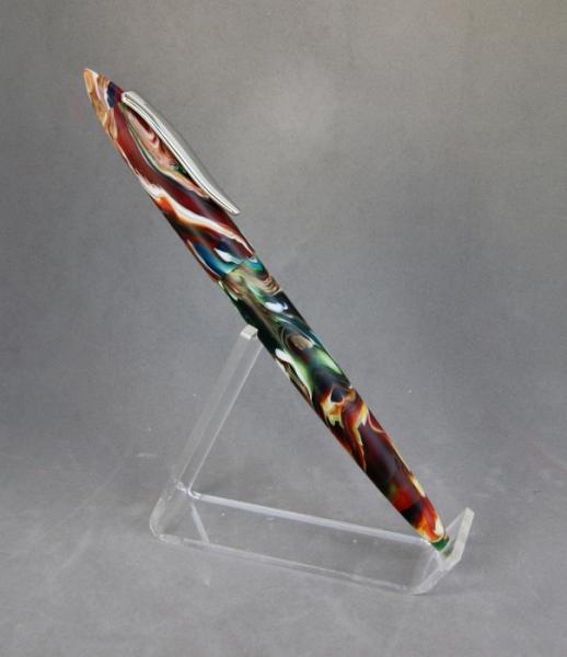

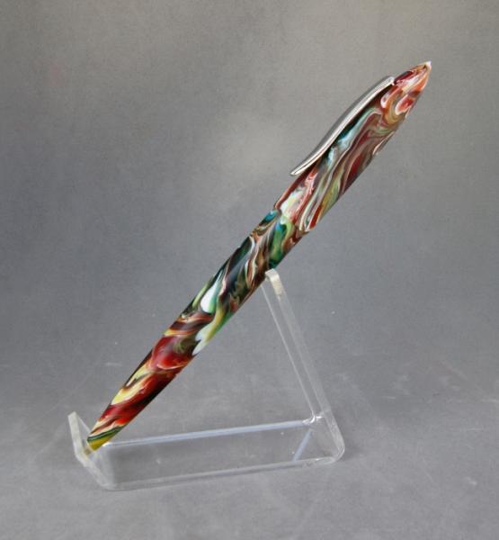

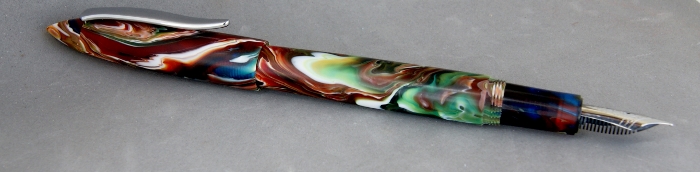

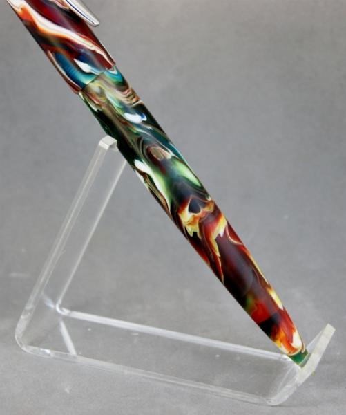

Here's what can happen when you throw the color wheel into a batch of resin! This is a 7 color Alumilite pour. Needless to say I had to work FAST!

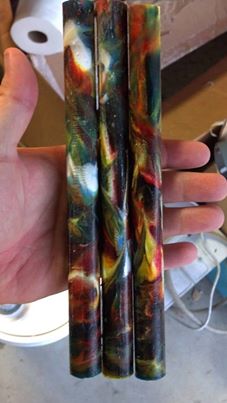

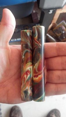

Here's the raw blank fresh from the pressure pot:
Then turned down a few mm on the metal lathe:
It looks a bit dark and drab, but once I got it drilled out and turned down more the light hit it and WOW! I was doin the happy dance :biggrin:

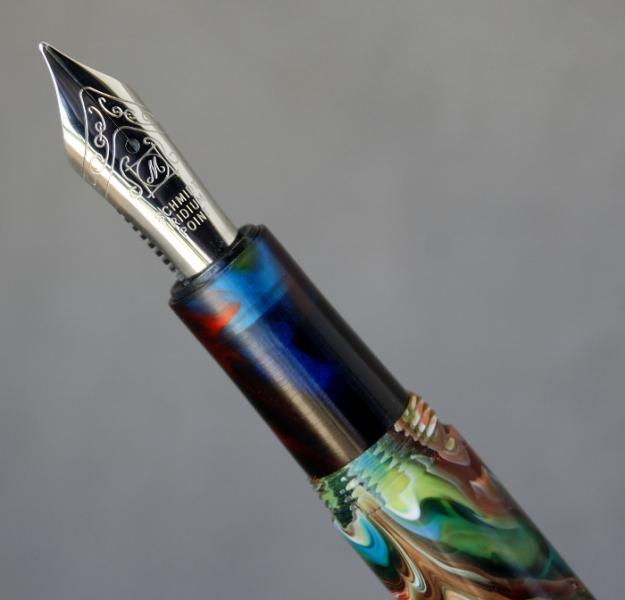

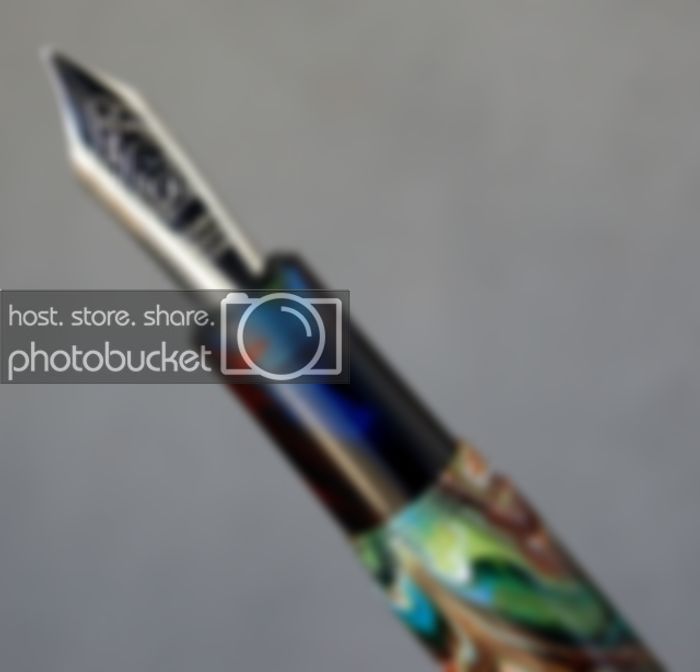

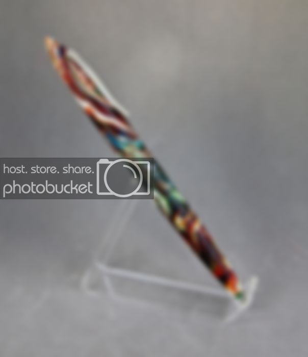

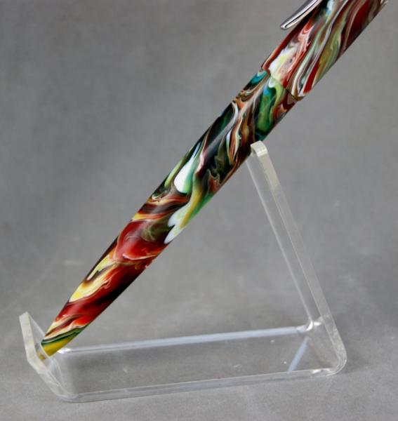

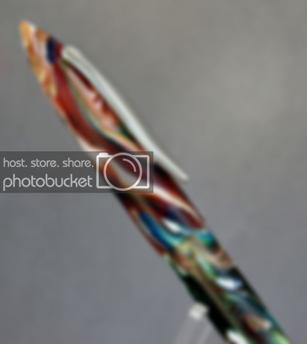

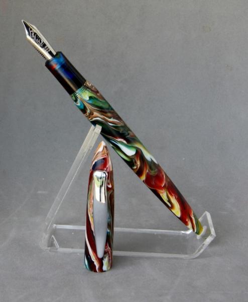

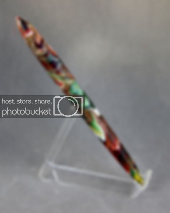

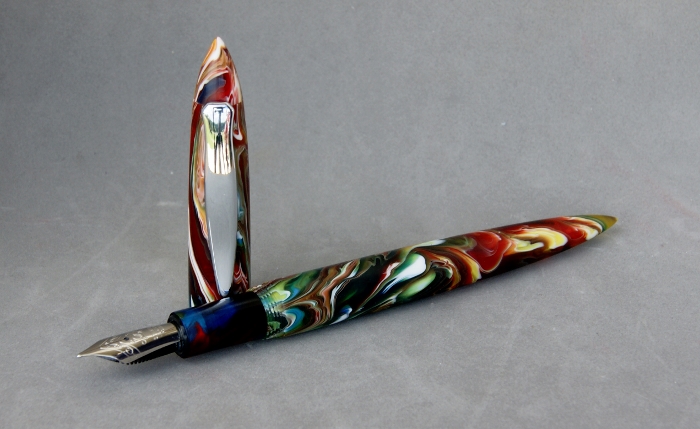

I also tried a new shape. I really like the torpedo look. I think it was the perfect choice for the blank. The section is of the same blank, I just used a part that didn't have as much going on so it wouldn't be to overbearing. I purposely did a satin finish on it. It's sporting a steel Schmidt nib.
DSC03443 (604x700).jpg DSC03449 (558x700).jpg DSC03451 (648x700).jpg DSC03456 (576x700).jpg DSC03457 (700x429).jpg
DSC03459 (700x172).jpg DSC03446 (624x700).jpg DSC03447 (584x700).jpg DSC03453 (661x700).jpg DSC03455 (700x672).jpg

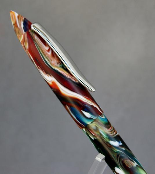

Close ups:

Over the top! Not only is the blank awesome but that pen leaves me speechless. All of those colors look fantastic together. Kind of reminds me of a peacock. I don't know how you managed to get all of that mixed in such a small window, but you are in the zone, Keep running with it! Front Page work IMHO.
Jonathon, that is one awesome blank! The satin finish is just perfect for that blank and the colors. Great as usual.

LOL...yup seven! Blue, Yellow, Red, Green, Orange, Purple, & White. The Purple doesn't show through as much as I'd like, but I can fix that easily. I had to be lightning fast to get it all in there in time. I was able to make them in batch of 4 blanks.

For those of you not familiar with alumilite, you have 7 minutes from the time you mix the 1st color till it has to be in the pressure pot. 3 colors gets pretty adventurous, and I have played with 4. But 7 :eek::confused::eek:.
