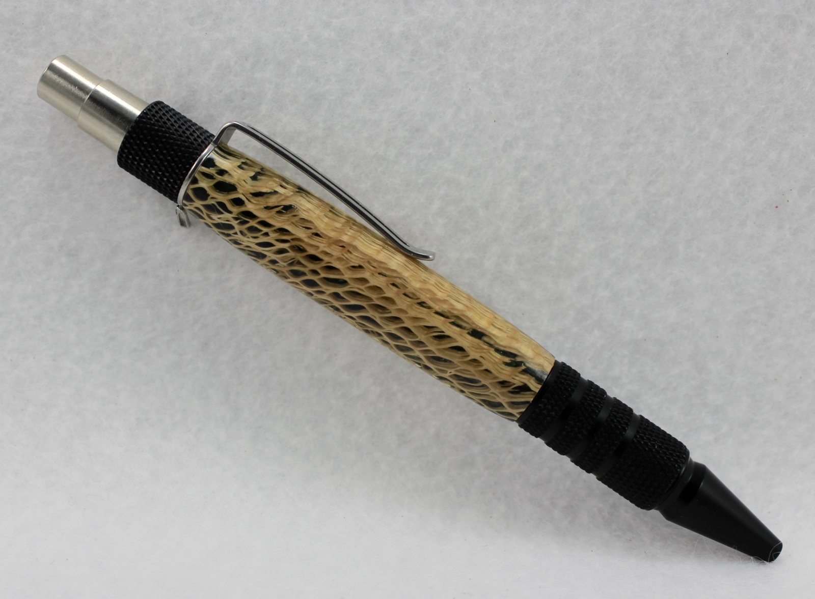

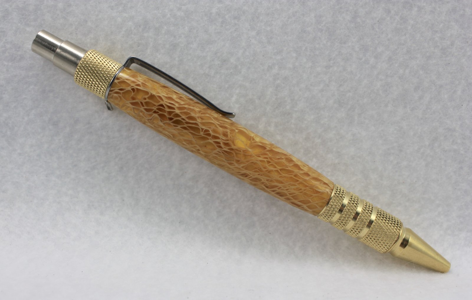

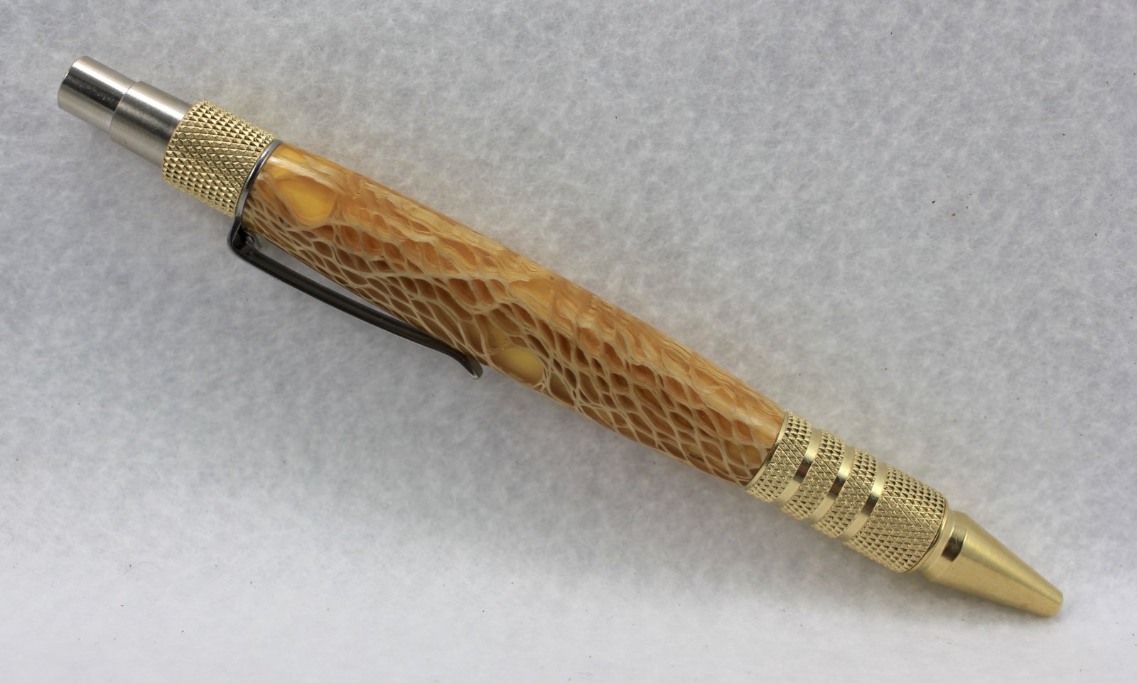

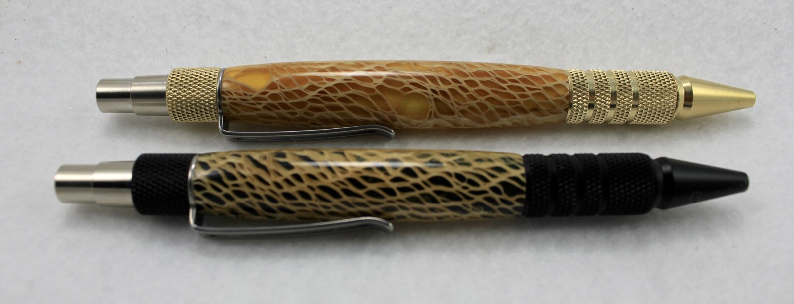

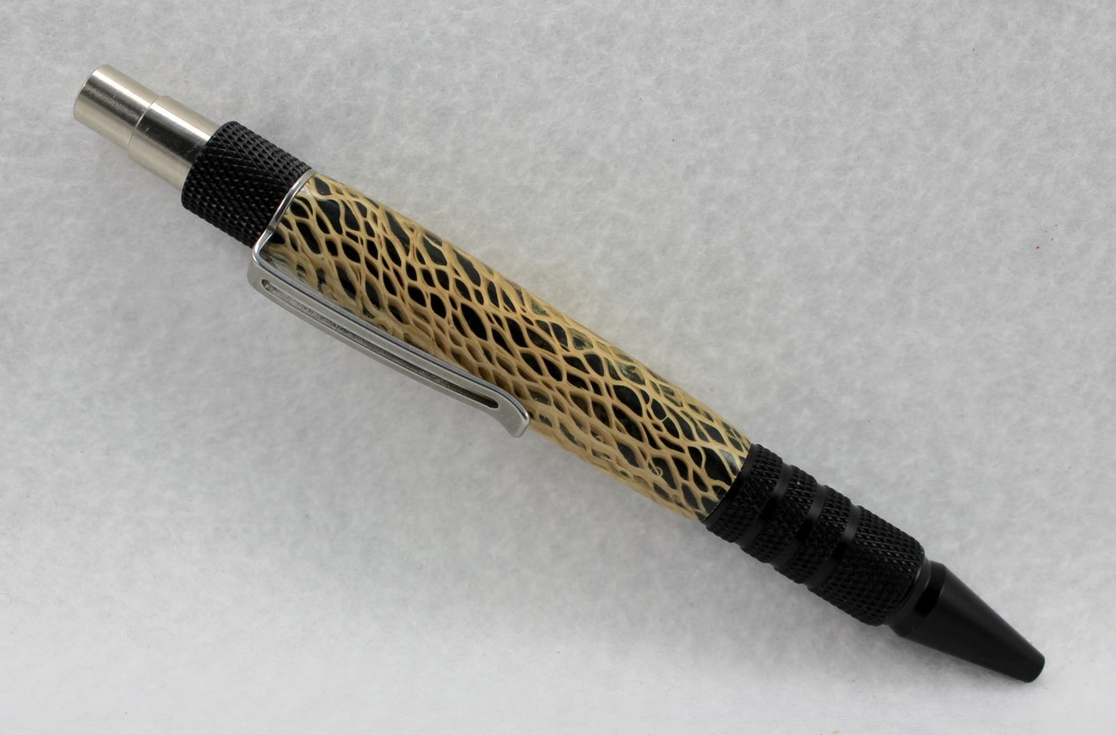

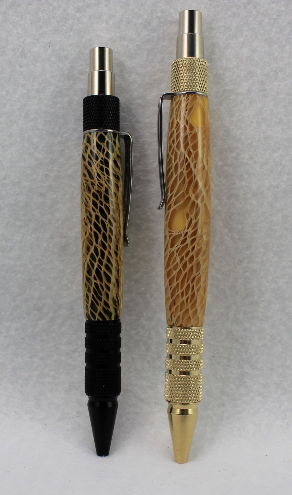

I finished these last night and just assembled a few hours ago. The yellow back-painted one I chatted about previously. I had just enough of the blank left for another EDC pen as long as I used the "modified" dimensions as others have described (discard the white extender atop the refill and shorten the tube by about 1/2").
For both blanks, I painted the inside of the blanks after drilling and painted the tubes, let dry overnight. Tinted my epoxy with the same color and let set overnight. After turning, I finished with Glu boost, 3 coats of each, then applied some Mcguire's Plastic Polish.
Yellow Testor's Enamel. Red, yellow and Blue Testor's Enamel mix to get a dark ugly color.

G'Day Alan. I bought these several years ago (I still have a second blank) from a famous gent in Texas - MesquiteMan. I do not know if he makes these blanks anymore. They were not cheap, but for what he needed to do to clean/prep the cactus carcass, it was not overpriced (I've made 1 or 2 custom blanks... I understand the time commitment). These were perfectly cast and turned nicely. I have been wanting to use them for a special order, and my brother wanted 10-15 of the Duro EDC's, so I dug one out. I prefer the dark background, but as we have read - the consensus is split between the Yellow and blackish backpaint.
Both are very cool looking Mark. I give the edge to the dark one because I like black, but I'd be happy carrying either one. Really nice job on these unique pens, and a great example of how backpainting can completely change the look of a blank.
I vote for the dark one. I like the clear cast with the colored background. Makes me want to try a cholla that way.
I turned 2-3 cholla a few years back and they were just not my cup of tea. I have a friend that resides close to Tucson, and while we hiked 2 years ago I got to see dead prickly pear cactus. I have a hard time imagining what Curtis (and others) need to do to prep these blanks. I could see the dead cactus, with stones, dirt clumps, bits of material in between each layer. The matrix is wonderfully detailed. Very refined as compared to cholla. A very unusual blank to be sure. Time to appreciate what nature presents us, either alive or dead.
And I also favor the darker background. ;)
