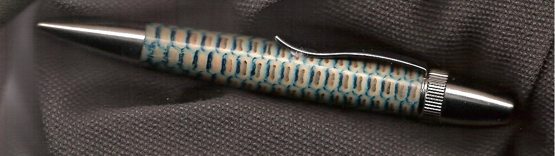

Okay, help me out here. HOw much should I ask for an Atlas pen made from a blue dyed corncob with titanium fittings - the silvery colored kind, not black titanium - with a really nice CA finish? Assume it's a fairly high caliber of craftsmanship and that fit and finish have noe observable flaws. (I ain't tooting my own horn - I just did good here).
Sorry for the lousy pic,but you know what I mean - it's a corn-cob pen.

It's obviously YOUR decision. But make sure you cover the cost of the CA glue!!![;)][;)][;)]
(I charge $38 for cobs, cigar-style, not dyed - hope this helps)

I have not done an atlas in corncob but I get $45 for a plain corncob cigar and $55 for a dyed cigar. They sell well for me. This price is for Gold, Chrome, & Black only; higher end platings are $10 more.

You can always fall back on the basic 3X rule of thumb. Cost of kit, including some for shipping, cost of blank times 3 and rounded up. If you made the blank, pick a fair representative price for what you would pay at retail. I believe somewhere in the $40.00-$45.00 range would be fair. A lot depends on your market. In some locations it would bring $100.00. In my town it wouldn't bring $10.00. (cheapskates)

I know this isn't the SOYP forum, but I have to say that is one of the best ccpens I've ever seen. I've got a half dozen pieces laying in my shop from Johnny, that I have yet to touch. HMMMMM!

HINT: glue your tube in before dying it and then turn it to a wee bit more than the dimensions of the final pen. This maximizes the depth of color and still lets the underlying cob color come through when you sand to a final shape. The cob may swell as it's being dyed and may not return to its oringal dimensions. It may end up a bit longer at the ends than before you dyed it. This mean use yopur pen mill again before you do the final turning.
