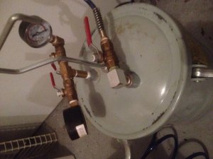

I took a look. As it turns out, I didn't plug up that hole. I didn't even remove the fittings that were there. I unscrewed the paint tube and screwed in standard copper fittings. In my pot, that side connects to my air line and the other side has my pressure and vacuum gauges, although I haven't used my pot for vacuum since I bought one of MM's chambers some time ago.
Pics to follow as soon as I can figure out how to get them from my phone to the forum.

Lousy sideways pic of the top of the pot:
