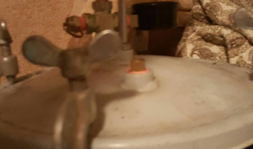

I need to make a wrench to snug down the wing nuts on my recently converted Sharpe pressure pot. The ears are not tall enough to use a screwdriver or similar. Any ideas or pictures to help me out?

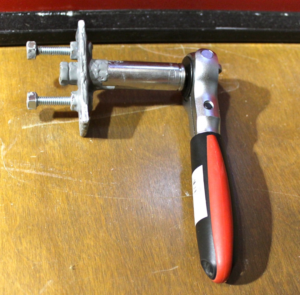

Found a pic..
Not pretty, but has worked great! A long socket, a metal bar attached with some bolts/nuts. two bolts attached to the bar. All coated with JB weld. IT allowed me to turn the wing-nuts of the pressure pot under a much higher torque. As I said not pretty, but cost me the wrench and socket... 3 yrs later, still works.
