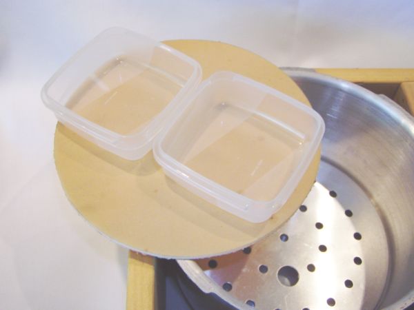

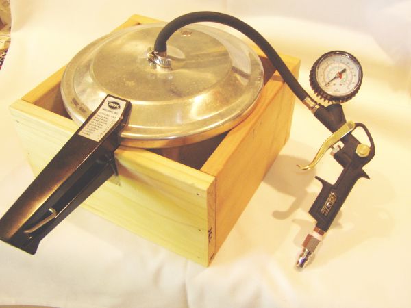

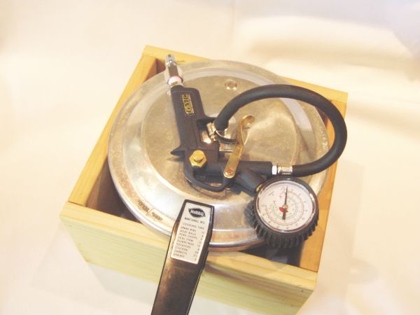

This is a pot I did in December 2005 for my first pressure casting as you can see the pressure cooker is incased in a wood frame the hold as is ballon up when under pressure but hold well a 25 PSI one nigth I left it connect to the compressor and the pressure went up to 60 PSI I was very luky he didn't explode I still using it only in 1 test blank casting, I use the HF most of the time more secure and you cast more blanks
edit: as poeple say better off to buy an HF paint pot you will be able to cast more blanks
