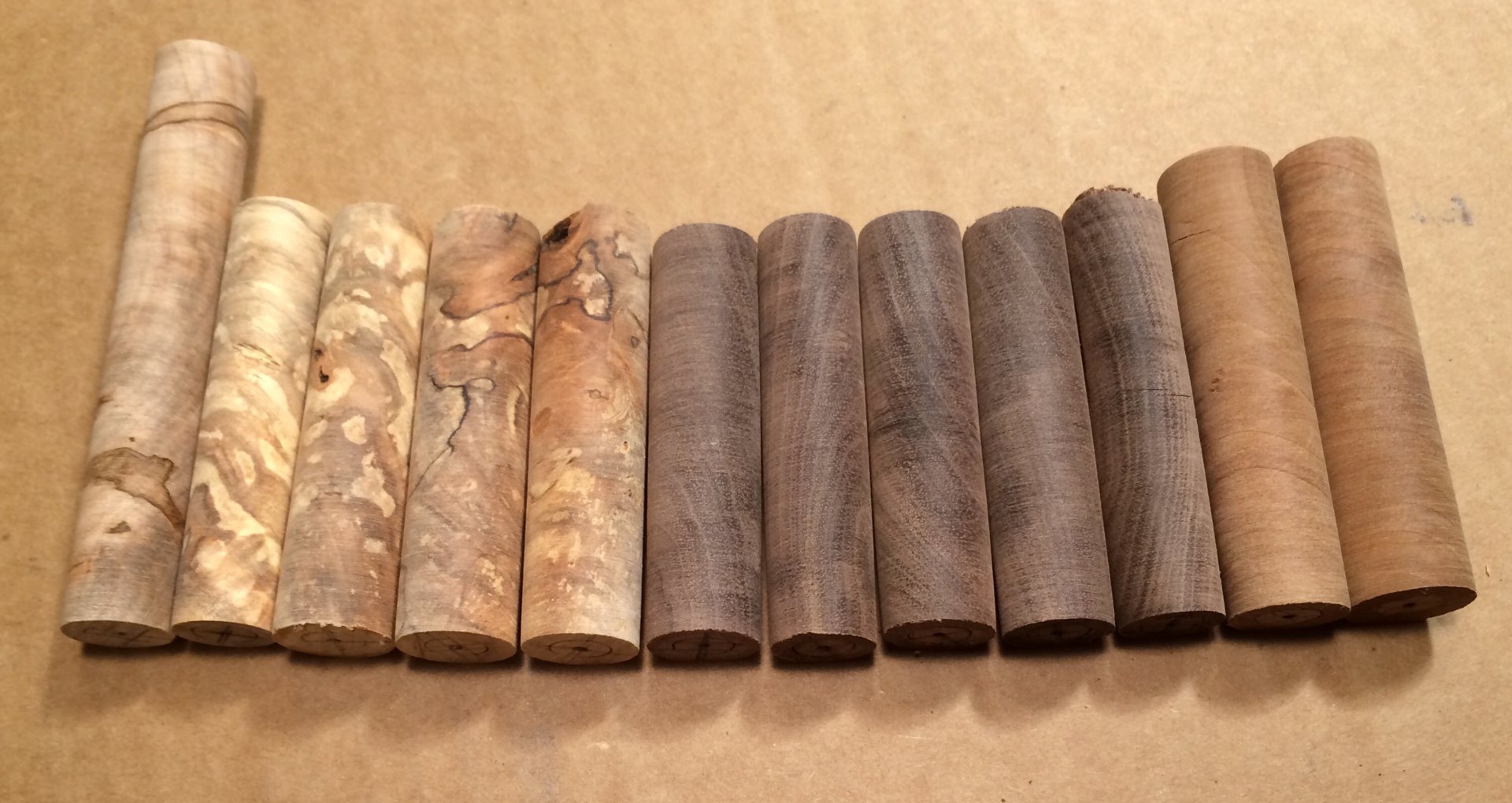

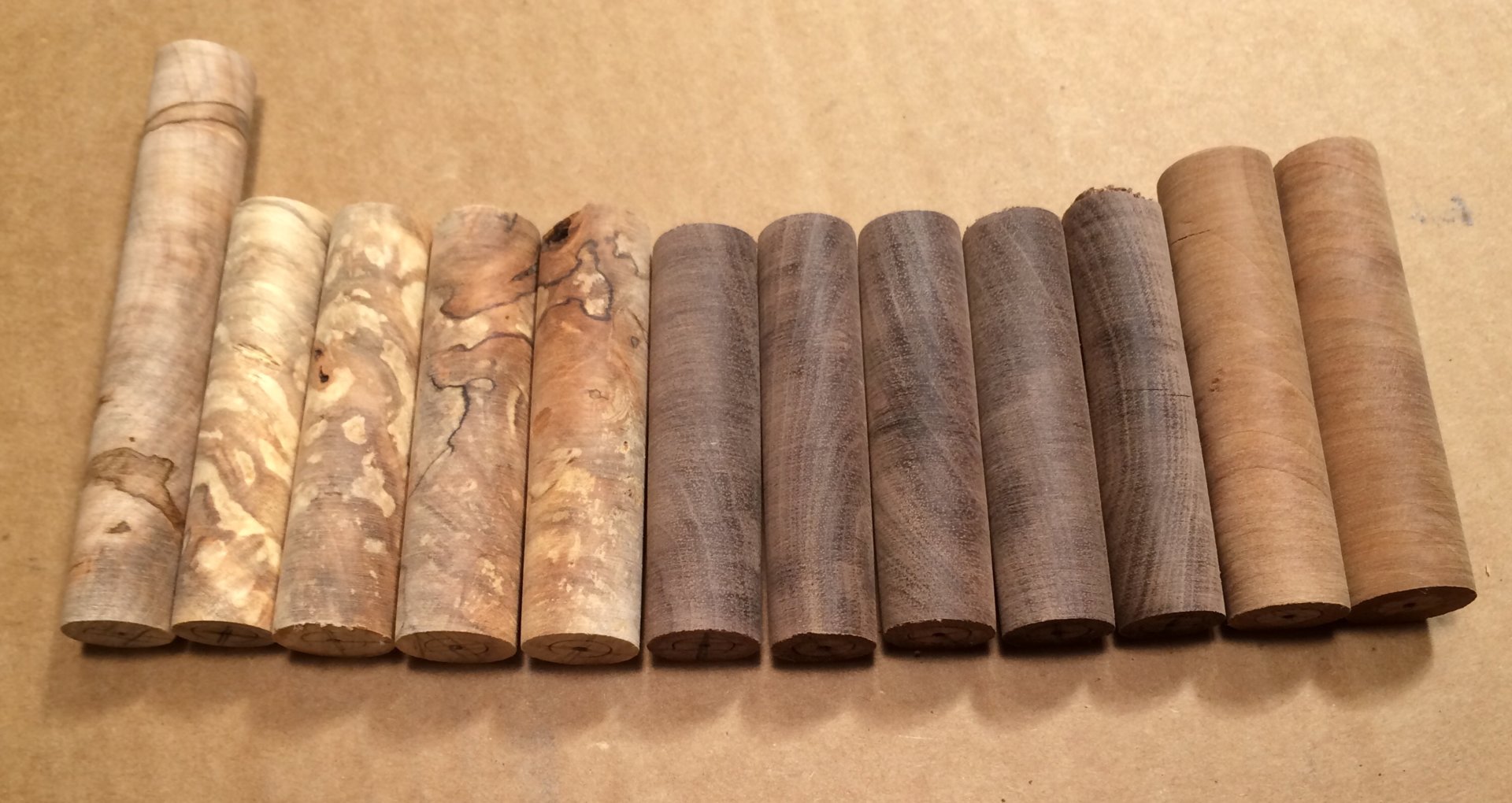

I had a handful of cross grain blanks and decided to prep them and see what I had. These are Ambrosia and Spalted Maple, Walnut, and Cherry. As they were rough cut on a Bandsaw, some weren't square or straight(parallel) and would be a challenge to hold for drilling on the lathe so I decided to turn them round first.
I cut the corners off with the bandsaw and then turned them round (between centers) with a skew. Then gave them a coat of thin CA and followed up with a quick sand with 80G . They are now ready to be drilled and cut to length when they find a kit they like. A couple had cracks which may or may not show when turned to size.
Well done, as always, Charlie. hope to see you soon.
P.S. I had a similar issue with old teak recently. I did the same - CA over all cracks until satisfied they wouldn't shatter while turning. End product worked out nicely.

Interesting as I never thought of cross grain blanks.
John, Cross or diagonal grain orientation can give a whole new look to many woods. Note that the blank is more susceptible to chipping and tear out while turning. That is why I first beveled the corners and used a skew to turn these.
Also, use care when drilling as grain can separate if there are too many chips in the hole as you withdraw the bit.
