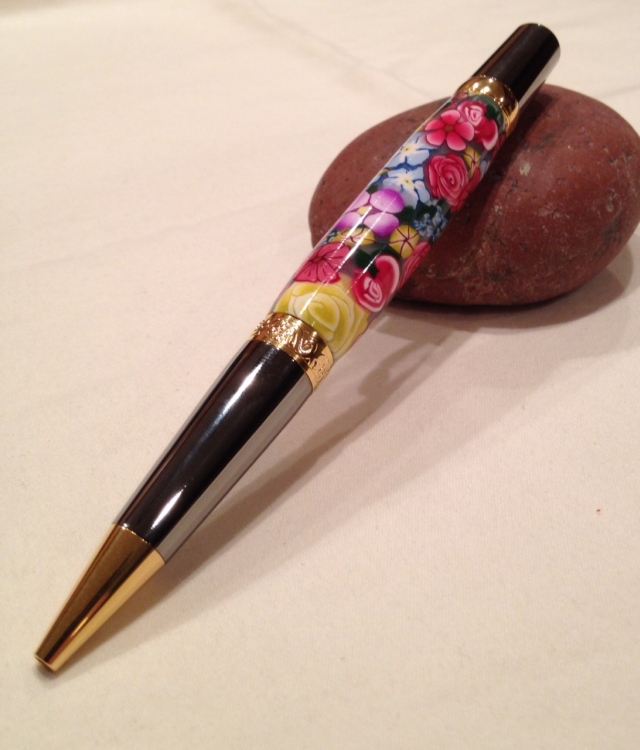

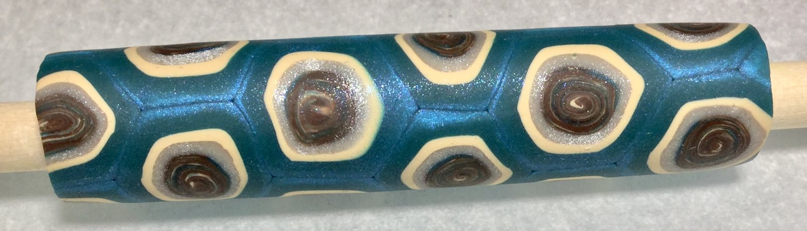

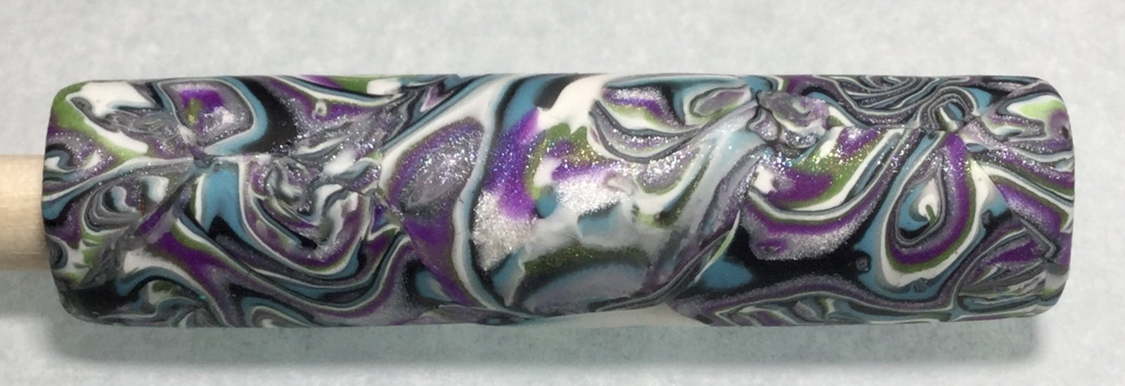

Two of the first three test pen blanks performed well on the lathe, including sanding and CA finish. The third test blank, not so much, lol. Major chip outs, most likely due to the extra glitter I added. Oh well, it's a learning journey! Have two more test blanks baked and ready for testing today.

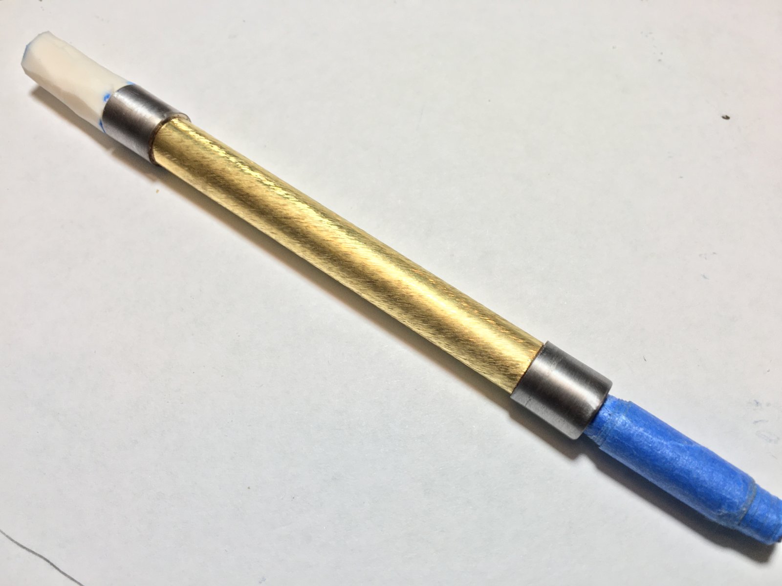

Two out of three isn't bad for your first try. I'm sure you'll learn as you go. What kind of tool did you use to shape the blanks? They'll make lovely pens.
I make polymer clay canes by hand, reduce to 3/4" rolls & chill. While can is chilling, I wrap a a base layer of extremely thin clay onto the brass tube using a makeshift mandrel and kit's bushings, then apply slices of the cane onto the base layer
