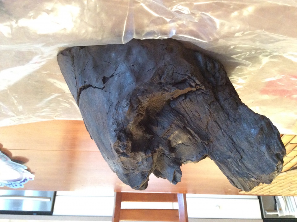

Lots of cracks and voids I'll have to deal with. I need to figure out how to upload photos... Any help?
Steve
I think I got it...

well I'm sure there are a few guys (and gals) that would like to get there hands on some of that.
It's unlikely I'll be able to get much more, it's treated with the same level of security as the kimberlite (Diamond ore) at the mine. I had to do a lot of campaigning to get this small piece. If I can get some more, I'll definately try to pass some on to a skilled turner to see how it turns out (I'm not the said 'skilled turner')

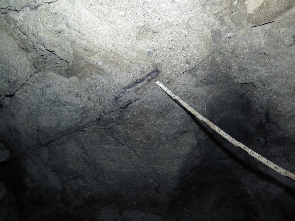

It's a security thing, or at least a perception of security thing. You can imagine that security at a diamond mine is high. The wood comes from the same rock as the diamonds and we have a blanket rule that everything that comes from the ground is treated the same weather it's diamonds, the kimberlite ore, granite or wood. So the answer is nothing. To the best of my knowledge, this piece is only about the third that's ever left the site like this. Most of the wood that is found is obliterated by the excavation process, so to fond a piece like this is rare.
I think I've attached a pic of some wood embedded in the ore in one of our underground tunnels, the only way to get it out is to blast the rock

Thanks for the photo, Steve. That certainly helps to put it in perspective. Congratulations on the score & I hope you will be able to get more sometime. That is a rare find indeed.

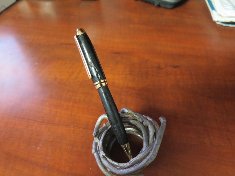

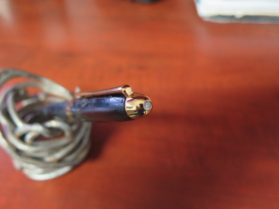

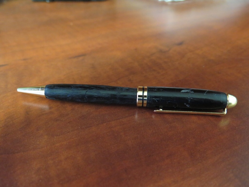

I finally got a pen turned from part of the sample I have. I decided not to cast it because the wood is so dark and wanted to get a more 'authentic' look. Like it or not, it turned out exactly how I wanted it to (much better in real life rather than the photos - that I think are attached)
I also got one of our diamonds set in the top to set it off. It's a big hit up here on site!
A big thanks to all who gave advice and encouragement on this one!!!

WOW!! That is absolutely incredible, Steve. Beautiful job, staggeringly lovely pen. You have folks on site who grind and set the diamonds, too? I'd like to hear how difficult you found it to turn.

Hi Katya, we don't cut/set stones on site, but we do have the opportunity once a year to buy our own product that has been cut and polished and brought back to site at very reasonable pricing. I got this done at a jewller in Calgary.
As for how it turned... Not so awesome, I had two pieces that self destructed on the lathe. I think it was a combination of not enough CA on the tube and an issue I had because I used a 'home made' vacuum chamber that imploded about 15 minutes after I achieved a decent vacuum. The Cactus Juice did penetrate fairly well, but I would have liked to give it another half hour or so. I've learned a few tricks that will improve the success if I get a chance to do it again.

Great looking pen & definitely one of a kind!
You could almost say that it's "older than dirt"
Wow!! Yes, I would think that pen would be put away out of reach but in sight. I really hope you get your hands on more. I would love to see more of those. Great job considering what you had to work with.

Thanks for sharing a glimpse of it. How did it finish, was it like any other resin blank since you 'Cactus Juiced' it?
