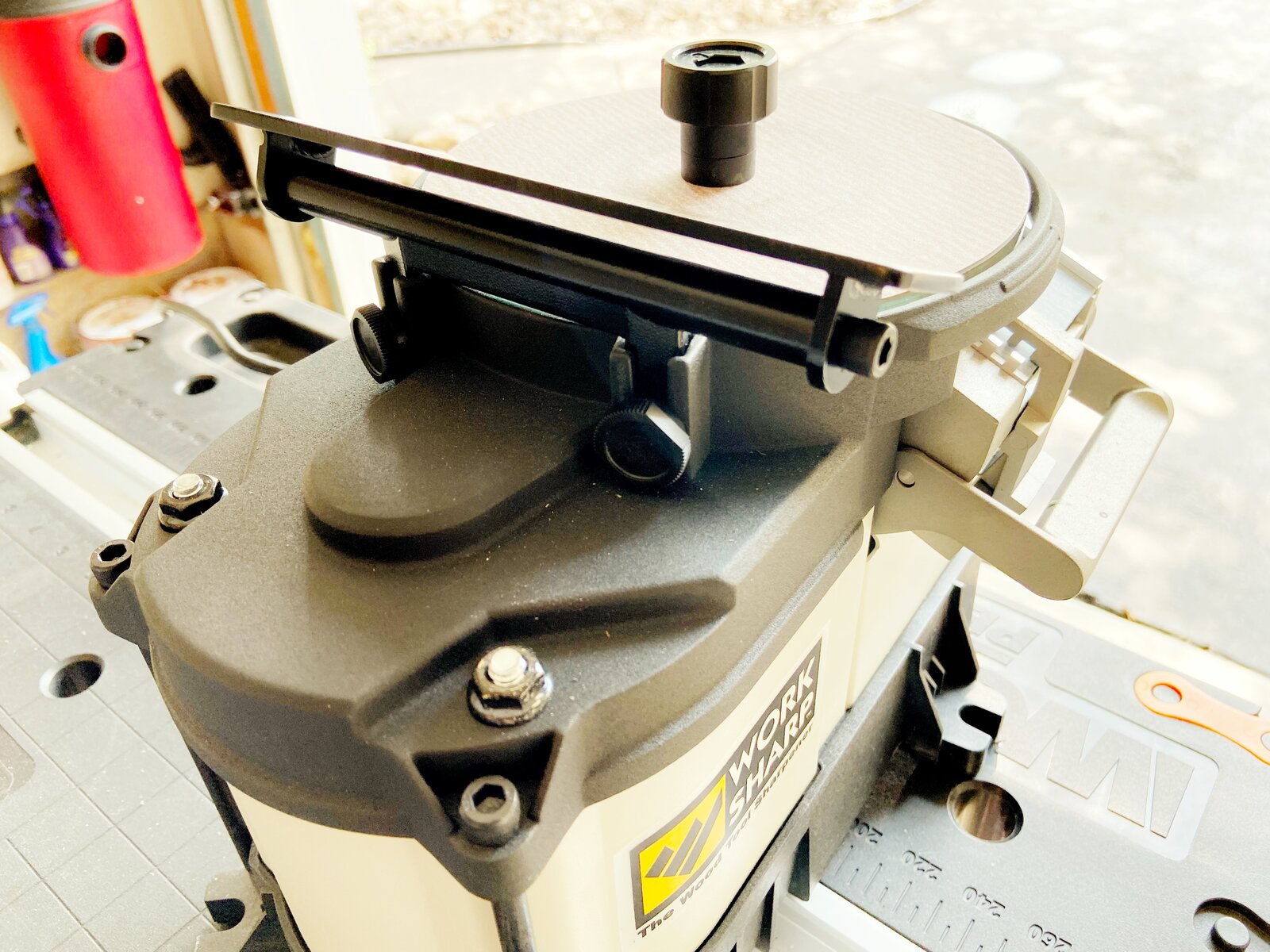

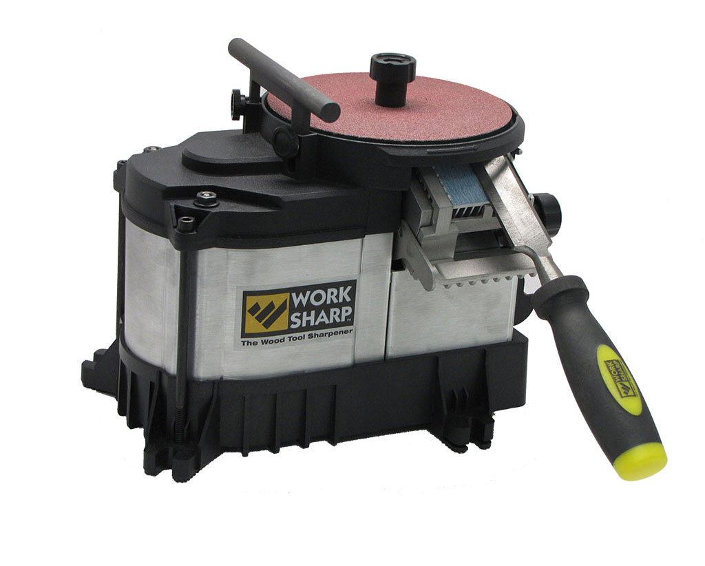

My WorkSharp makes quick work of skews and gives a nice, flat grind.

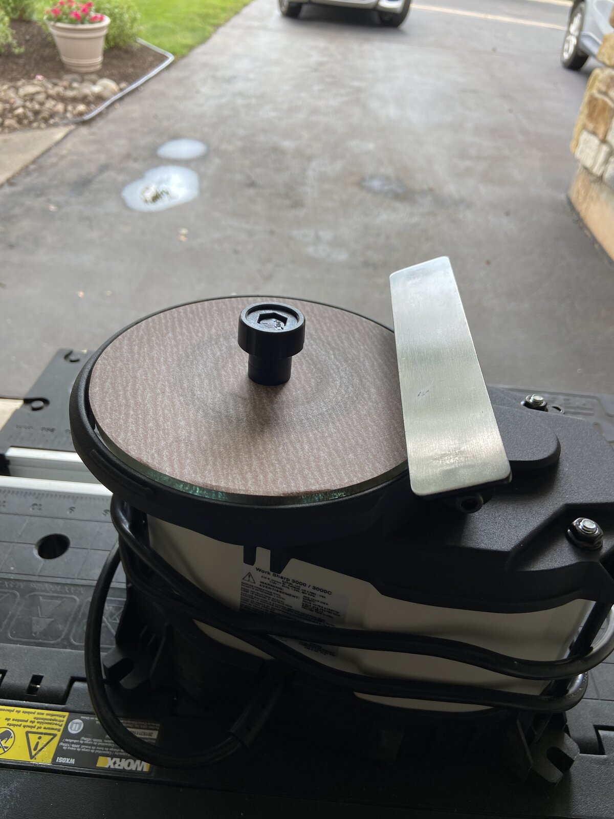

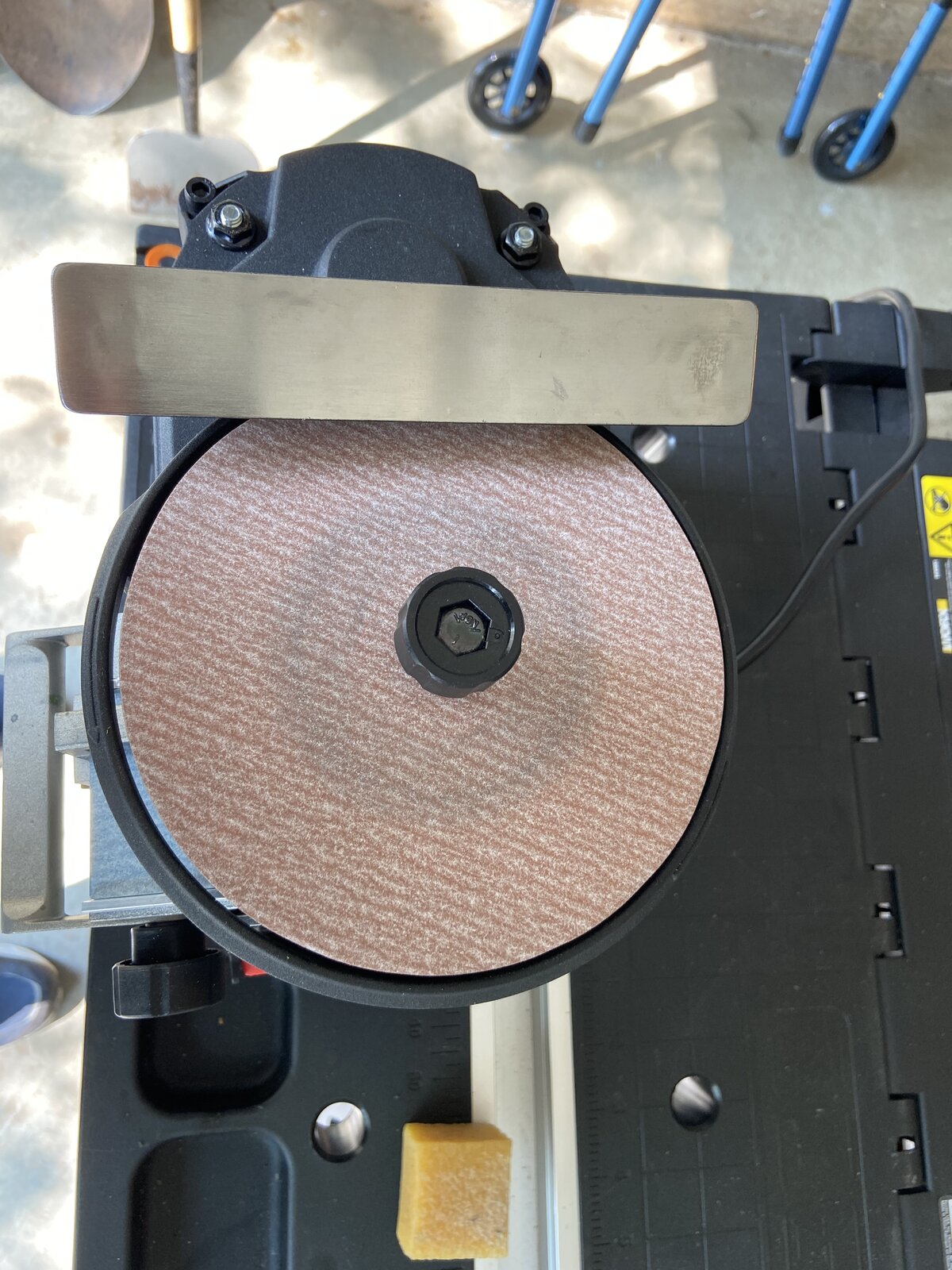

Rick Harrell just fabricated this for my newly purchased WS3000

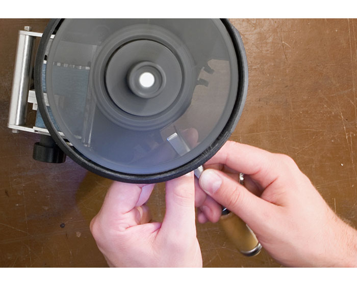

Depending on what angle you like your skew, and assuming it's not too large, the 3000 has a built-in bevel guide. With the slotted wheel, you can actually SEE your bevel while you sharpen. Incredibly handy.
