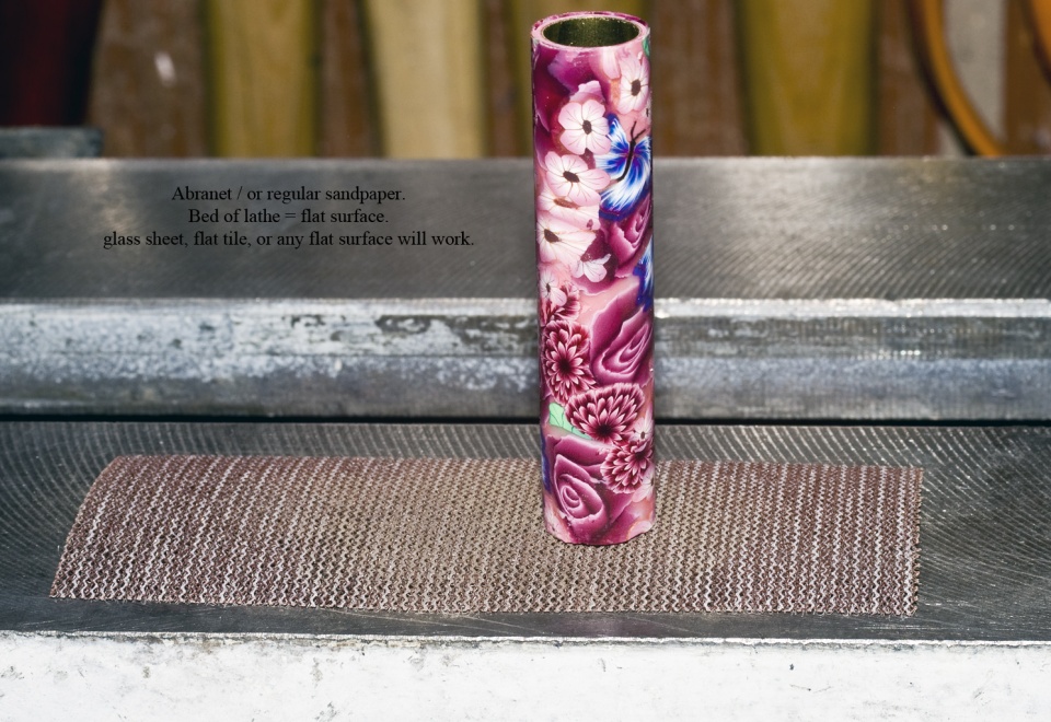

I use the bed of my lathe and abranet for this job. You can use plates of tile, ceramic tile, or any flat hard surface material. This is a reference point as any imperfections will bleed over to the lapped surface on the tube.

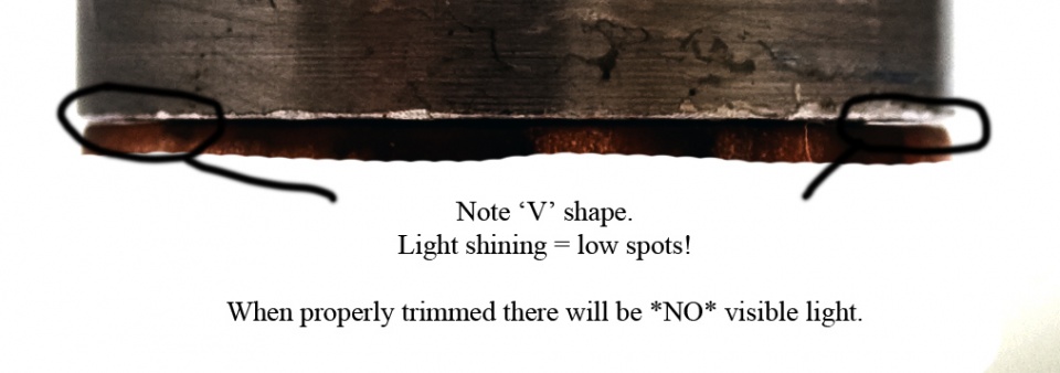

The first thing you do is put the bushing on one end of the tube. Put a light source behind the bushing/tube joint and look for cracks of light.
If you *DO* see light, and you will in most cases, this means there is a low spot. When you hold the bushing and rotate the tube the crack of light will change and you can easily find the high spots. The high spots are areas that does not show light.
attachment.php

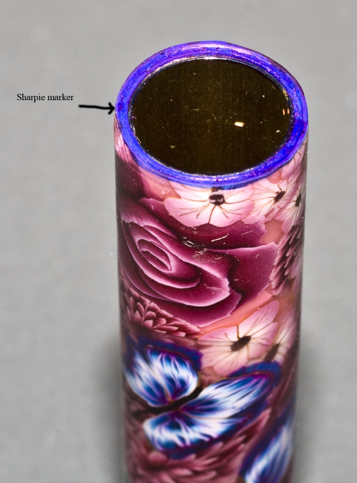

If in doubt you can break out your sharpie maker (permanent marker) and cover the end of the tube, that way you will see very clearly what is going on and where.
attachment.php

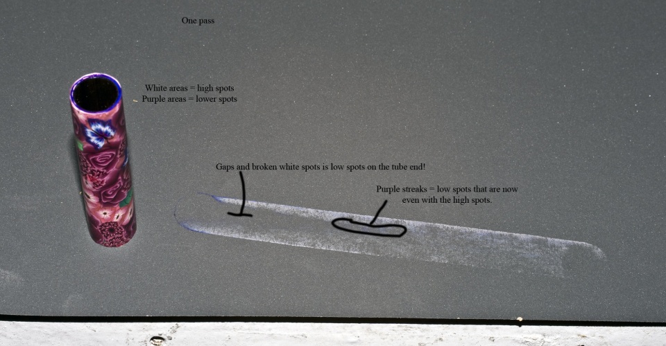

Then we do one pass on the paper and read the paper.
attachment.php
Worth noting, look on the tube, see the purple spots at 3 and 9 o'clock position. Then look at the residue marks on the paper. See the gap in the middle? That is where the purple (low) spots are on the tube.

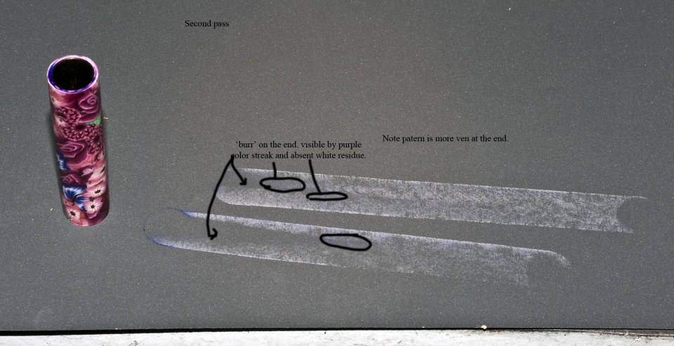

Two passes.
attachment.php
Also worth nothing it took 2 passes to remove the bulk of the low spots. the gaps we saw with 1 pass is mostly gone.

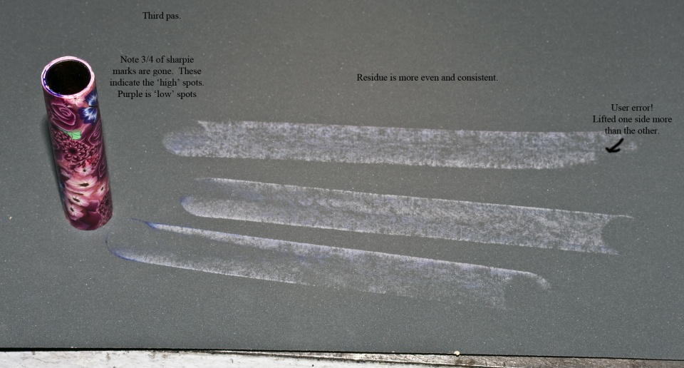

Three passes.
attachment.php
Ok technically I think we could call it at this point but there is some ever so slight low spots. So I am going to continue a few more passes.

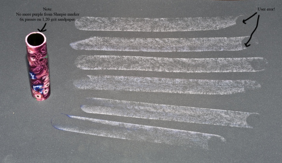

Six passes.
attachment.php
Here we clearly see it took 6 small passes on 1,200 grit sandpaper using a very LIGHT and GENTLE touch and only left to right motion to trim the end. We have NO purple remaining on the tube. The paper tells us we have smooth fluid even residue marks, no purple spots and no gaps. The only remaining thing to do is check step 1 with the bushings again to ensure there are NO low spots.

The 'user error' that is mentioned in the photo's are from the tube being uneven to the paper. In this case was when I was lifting the tube at the end. Knowing this we can see that I screwed up on pass #1, 3, 5 and 6. Since they are at the very end there is little damage but this damage does increase vastly with the more pressure you apply.

This is why you check it with a bushing, find the high spot and touch that area for a few laps then recheck. If you blindly just rub rub rub away then yes you can get it grossly uneven. Each pass you make needs to be deliberate and precise.
