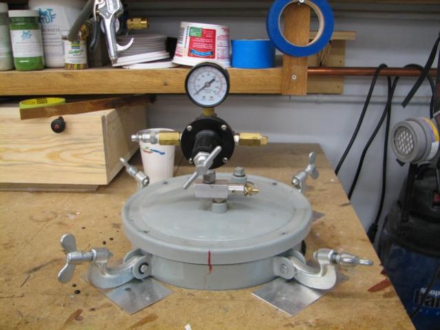

Here's what I did.......
This is for pressure only. You can see the plug on the lid and the plug on the right side of the regulator. That's all there is to it. I use the pressure relief valve manually to let the air out. Real simple and it's worked great for over 2 years.
