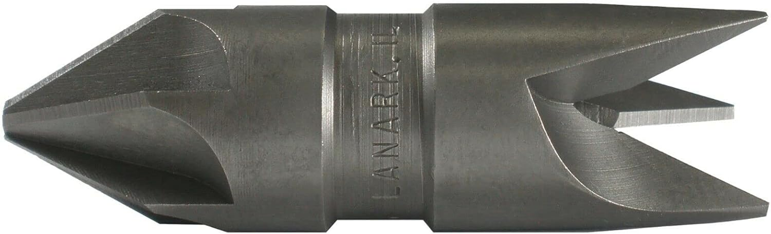

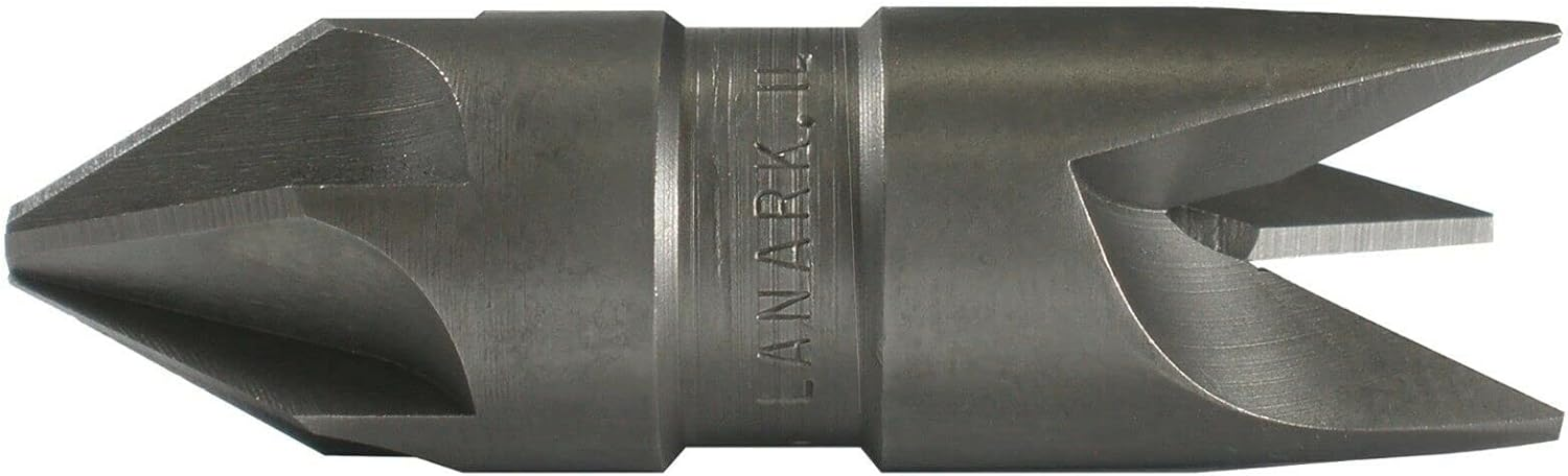

I've used a mini tube cutter but those end up rolling the ends. To fix that I take a punch and pointy side towards rolled edge, inside the tube, I try to convince it back to straight. I've also cut a but long and used a 60 degree deburring tool to slice off the rolled edge.
