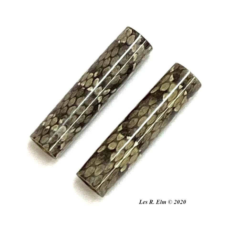

Rattlesnake skin anchored to Bolt Action brass tubes that were painted with
Krylon Olive Green Satin using Med CA.
Removed scale covers and wiped down with some Acetone.
Cast using Polyester Resin in Resin Saver molds.
Turned To size, buffed laterally and radially with ultra fine steel wool
and polished with Hut Ultra Gloss.
Les
Les
Nice Les. Those look amazing. Stay safe my friend.
